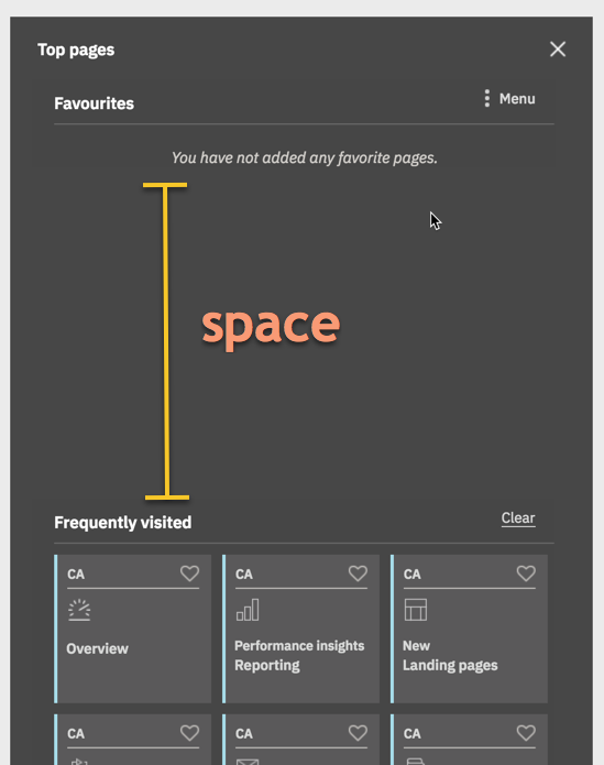

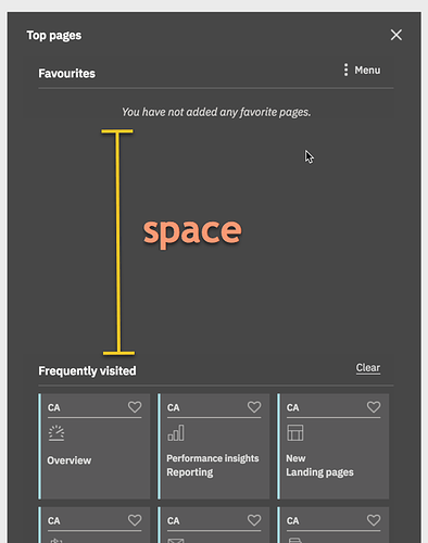

May I please ask you if, by any chance, you could please help me with finding the answer to the mysterious disappearance of the title on the cards when they are moved from the ‘Frequently visited bucket to the "favourites’ bucket?
In your great original file this interaction works perfectly, but in my version of this interaction, the title doesn’t work for the reason that I can’t understand. TopPages-CA-TitleMissing.rp (382.6 KB)
Would greatly appreciate your advice on this!
Thanks in advance,
Natalie
Hi there - the OnItemcopy raised event generated by clicking the heart is adding the new ‘row’ in the other repeater - but is not adding the variable varTxtTT into the TXTTT column. So it’s empty.
