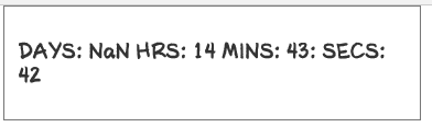

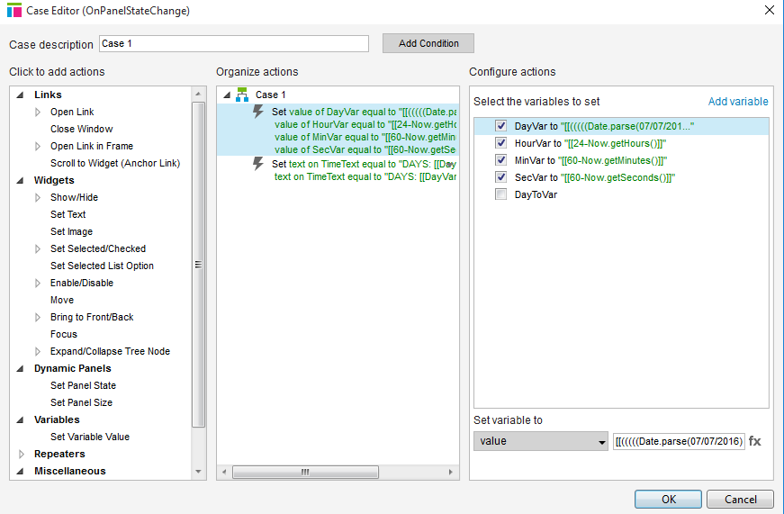

Brilliant Stuff!! I am trying to update DayToVar string but the result shows NAN in prototype
can you please guide me on this…uploaded pics…thanks in advance!!!
Can you show the full value string you are trying to set the DayVar to?
Thanks for your quick response !! Had attached he rp file for your perusal…basically i am trying to replicate a countdown timer to a football match!!
CountDownTimer_v1.rp (62.9 KB)
In your OnPanelStateChange, you need to change where you set the value of ‘DayVar’.
Where you have Date.parse(12) change the ‘12’ to ‘DayToVar’, so it reads Date.parse(DayToVar)
Then, change the OnPageLoad to set the value of DayToVar. So, for example, if you wanted to count down to Christmas, you would set that variable to be ‘SUN DEC 25 2016’.
Thanks for the response… but i tried as you quoted but still the same result…I had attached my RP again…
CountDownTimer_v2.rp (62.8 KB)
sorry to bother guys!!! can you please help me on this. I had updated DayToVar variable on pageload still it displays NaN
Not sure what the issue is - your v2 file is working fine for me. Have you tried clearing your browser cache?

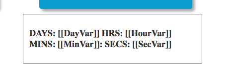

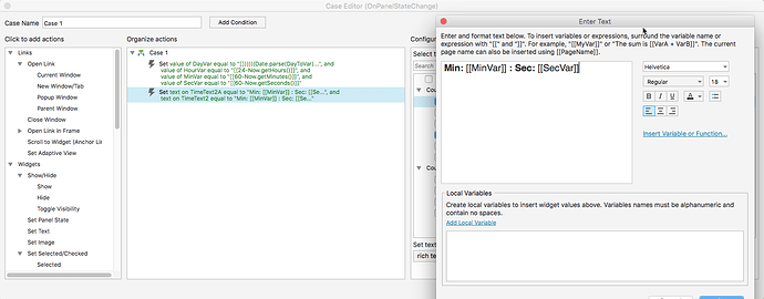

Thanks for this, Aadil. But I have an issue of getting it to work when I import it into another project. It shows up like this.
Any tips please and thanks? :slight_smile:
Did you import the variables?
Hello Friend,
You will need to ensure that you have copied across all the variables and formulas applied to those variables.
Only then you will able to get the count down timer to work.
