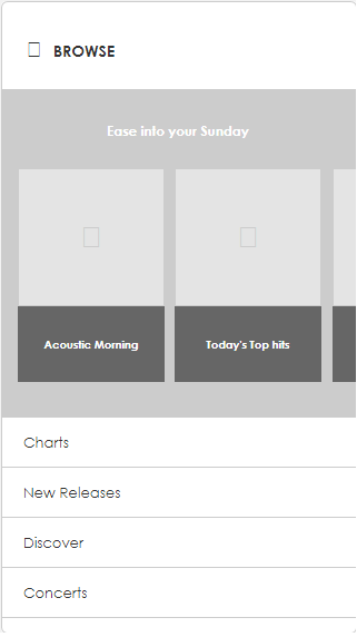

Which steps do I need to do in order to show only what is in the view (like that image on the picture, there is only a little bit visible - meaning there is more items, …)?

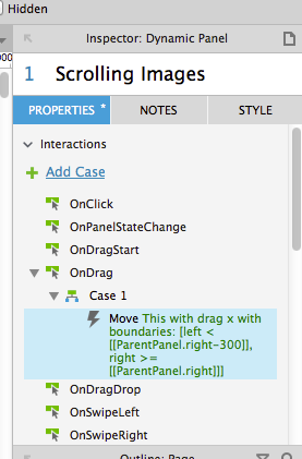

Alternatively, you can add an OnDrag case to the child panel and give it a “Move with Drag X” action so that it only moves horizontally when dragged. To limit how far it can be dragged (i.e. prevent the user from scrolling it beyond the boundaries of the parent panel), you can use the “Boundaries” properties on the “Move” action:
