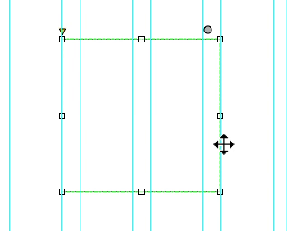

It’s been a year or more since I have this problem that makes my use of Axure much less pleasant and less effective.
When I hover a guide, the cursor will blink and it will become difficult to move. I have to push my mouse very far to stop freezing on the guide, which slows down my work considerably.

Hmm, I’m seeing some similar blinking behavior on my end when I slowly move my cursor up and down the vertical boundaries of a widget that’s placed along locked vertical guides. Could you please let me know if this behavior is occurring when your guides are locked? If so, does unlocking the guides change the behavior at all?

Thanks so much for trying that out! Just to confirm, is the glitch happening in the exact same way when the grids are unlocked, or is another cursor icon, one that allows the grids to be dragged, appearing? I set up this scenario using Axure RP 8.1.0.3382 with Mojave 10.14.2, and when I testing out hovering and moving over an unlocked guide when a widget was placed on the guide line, the cursor would change to allow for the guide to be adjusted, rather than blinking in and out of view. Could you please let me know if the blinking behavior persisted when the guides were unlocked?

Don’t know why but the capture doesn’t show how fast the blinking is.
The blinking is way faster when guides are locked. But they are about the same, annoying and slowing me down.
