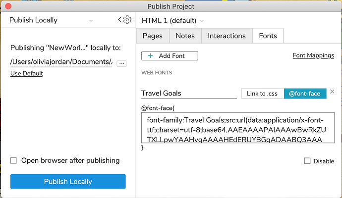

I just copied and pasted the link that was created into the section, which is probably not right but i don’t know what else to do - screenshot attached
Are there any errors in the browser console?
The next thing I would check is the font-family CSS role that Axure is generating for that font, it’s not always correct and sometimes you need to set up a font mapping rule in Axure to fix it.
