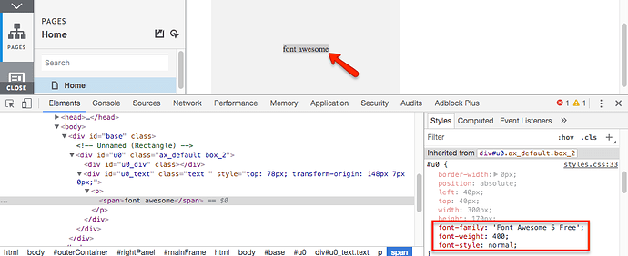

I did some testing with your file and I’m seeing that the ā€œFont Awesome 5 Freeā€ font is correctly rendering in both Chrome and Firefox. Here’s what I’m seeing on my end in Chrome in both the preview and published versions:
Would you happen to be seeing something different on your end? You can check which font being rendered by selecting the text, right-clicking it, and then selecting the ā€œInspect/Inspect Elementā€ option from the context menu. This will hopefully help get us started with some troubleshooting!
Given that this appears to be an icon font, have you tested it with any of the icon glyphs the font presumably includes?
Hi there! Thanks a lot for quick responds! I was confused by different look of font in browser and project file :slight_smile: Thanks a lot, happy it works)
