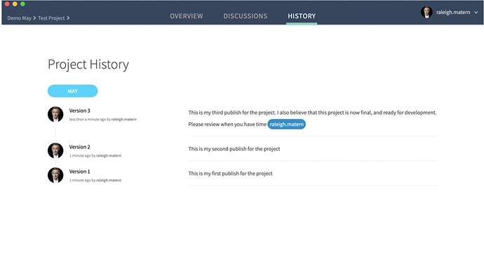

We recently released a “history” tab in Axure Cloud which shows you the various publish events and details for your Axure Cloud projects. Specifically, for each individual publish, it shows who published it, the date that the publish event occurred (if you are looking for exact publish times you can hover over the date field and it will show the specific time of the upload), as well as any publish notes that the publisher wants to share with the rest of their team.
To access this history tab and view the different publish events. Click into any project in Axure Cloud to access the project overview, then select the “history” tab at the top.
