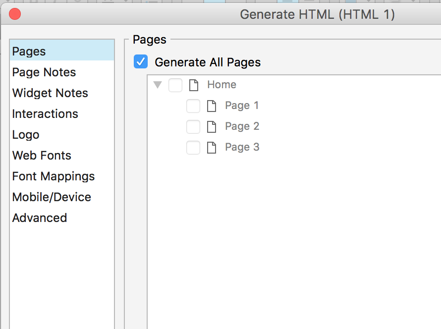

I’m trying to set up discussions on a local prototype. I’ve read how to make that happen, however the “Discuss” tab does not appear under “Advanced” as all the screen shots show.
Can anyone help me understand why? I’m using Axure 8, Team Edition, v8.0.0.3323

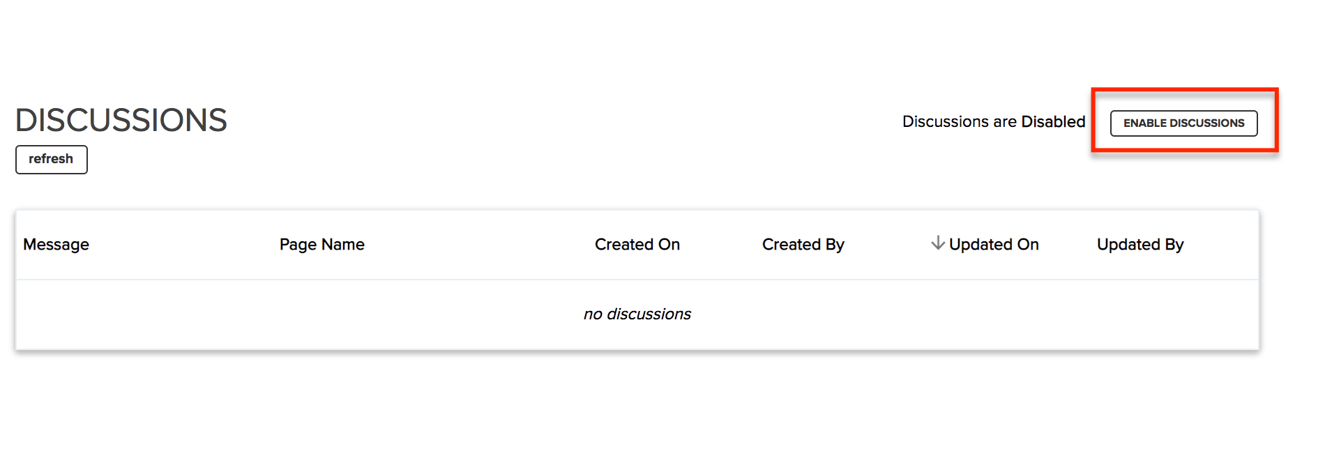

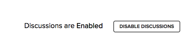

The “Discuss” tab would be missing from your HTML generator configuration if the file was published to Axure Share and discussions were disabled for this project. To enable it again, please log in to share.axure.com of the account where this project is hosted, click on the gear icon under “Configure” for the project to select “Discussions”, and click on the “Enable Discussions” button:

I am experiencing the same issue as joannewang. The discussions feature is not appearing in the HTML prototype even though it is enabled when I go to see its properties in the portal.
The “Discuss” tab should show in the HTML generator if you access it through “Publish > Generate HTML Files”. If instead you’re going through “Publish > Preview Options” then this option won’t show because discussions are not available for local preview. Hopefully that helps!
