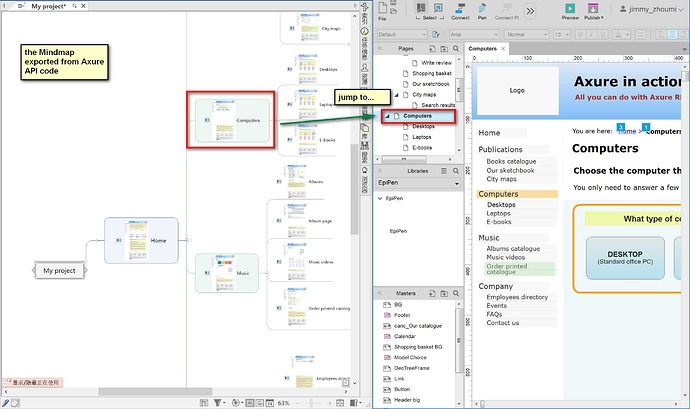

However, I more focus in “project management”, that is “make each page or widget easy to manage”. So I used Axure API code to export each page or widget 's information (including page name,widget name, notes, and screenshot…) into Excel or mindmap or other project management tool, then I can easily manage each page or widget 's LifeCycle by an Overview Excel or mindmap file.
While exporting process, my code 'd like to add the URI path link (or command line) into Excel or mindmap, in order for me to open certain RP page easily only by just one click at the link and do some edit things.
For example, when my teammember told me “hi, jimmy, you need to modify this prototype page design in your mindmap due to a new requirement.” Ok, I find and check this page status in mindmap, then I open the RP page by clicking the URL (that will be URI from RP) of this mindmap node and start to edit the design.
That is why I need the RP URI path for each page, especially in a big project with too many pages.
