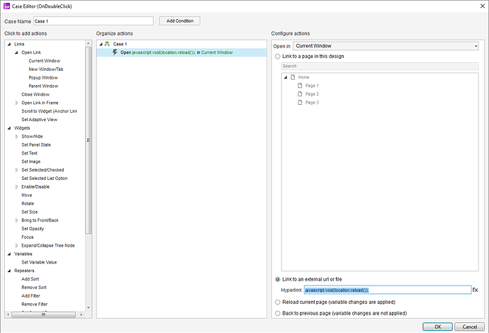

Under interactions, there’s a dropdown that says “More Events” - the first item in that list would be “OnDoubleClick”.
If you used that and had the action to be open a link to whatever page you’re on, that would accomplish what you’re looking to do. You can also use the following string and the value option to do a refresh via javaScript (for all intents and purposes this does the same thing, but you could copy and paste this event from page to page without having to update the reference to the page):
javascript:void(location.reload());
