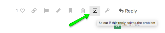

Is there any way to credit you through the system or mark your post as the answer like on stackoverflow?
There is! When a user has resolved your issue, you can click the “…” under their response and click the checkmark icon to mark the post as the solution.
