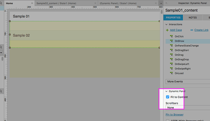

Is it in a Dynamic Panel and if so is the Fit To Content box checked?
Yes it’s dynamic panel and accordion is opened.

Make sure this little dude is checked
Fantastic. Working fine now. Thank you very much.
