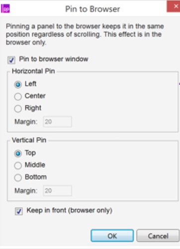

I have issue with fixing left navigation. I need navigation which should be fixed at left side and it shouldn’t be scrollable top to bottom. When I scroll content from left to right, then left navigation shouldn’ scroll. Only content should scroll from left to right. I tried using pin browser but I’m not able to scroll top to bottom. Could any one update the solution. It would be good if you provide me the solution.

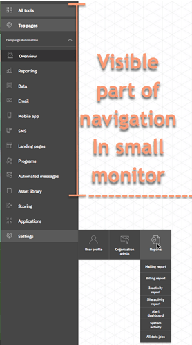

Thank you for your quick respond. I have attached the sample RP file here. I am working on multiple resolution support. I do not want any horizontal scrollbar within the table. I can manage browser scrollbar. If i see this in 1366*768 screen, my left navigation is hiding.
Let’s see if I understand your specific issue and expectations.
The left menu should be pinned to left of browser so that it is in fixed position or “floating” such that it does not move with horizontal scroll.
When the page is scrolled vertically, the left menu should not scroll vertically unless the user is engaged with the menu.
When the user is engaged with the left menu–cursor is over the menu area–and the browser window is shorter than the menu, then the menu should scroll to show the entire menu.

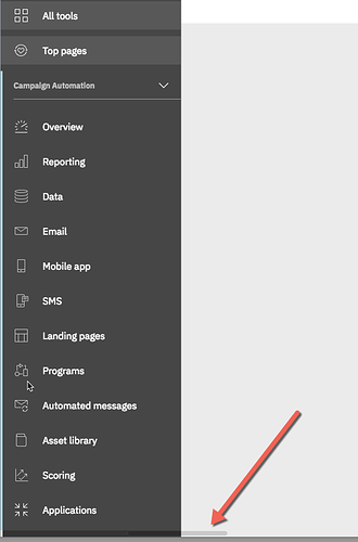

Not sure why the solution that you have posted doesn’t work on my end. I have tried to have the panel scroll in different browsers, but, unfortunately it didn’t. Strangely, I have noticed that a horizontal scrollbar appeared on the bottom of my screen.
Did you try dragging up and down on the menu? It works basically as a touchscreen-style “drag to scroll”.
I couldn’t get the OnWindowScroll method to work with your example. Perhaps it is too complicated and the scrolling doesn’t get captured properly–I’m not sure. Also, you need to have enough page content height to trigger the browser’s event handler for the mouse scrollwheel. Even when I did this, it would start to scroll the left nav but then stop moving it for some reason.
I did come up with this hack though… When a dp is set to “show scrollbars as needed”, then a scrollbar is shown automatically if the content of the dp is taller than the dp (for a vertical scrollbar) AND that triggers the browser to react to the mouse scrollwheel. So, you can get automatic scrolling for any dynamic panel this way, but only if the scrollbars are shown. This has frustrated me in the past when I don’t want to show the scrollbar. However, it occurred to me this time that the scrollbar could be hidden if the dp were wrapped in another dp and that outer dp was just narrow enough to not show the inner dp’s scrollbar.
Now, the width of the scrollbar will likely vary depending on browser model and OS, so if this doesn’t look right in your browser/OS, you might have to adjust the “sidebar” dp’s OnResize event code. So, the outer dp is named “sidebar mask” and the inner dp is still named “sidebar”. When sidebar gets resized–either OnPageLoad, OnWindowResize, or when cursor enters or leaves it, etc.–it resizes the sidebar mask dp to it’s width minus 17 px, which is the width of the dp scrollbar on my system.
