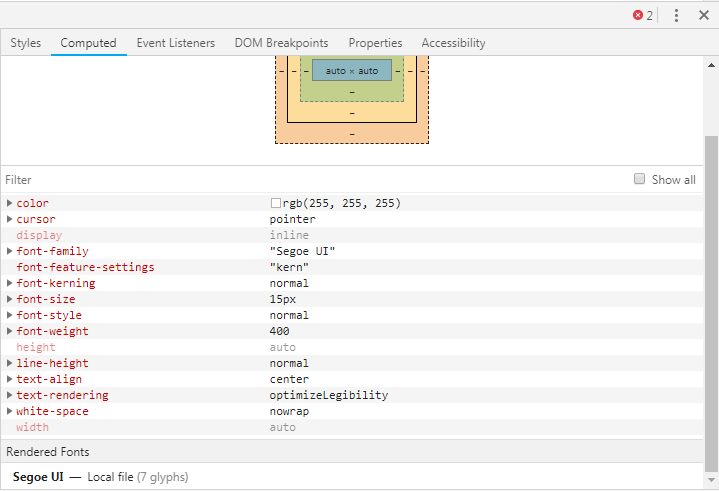

That’s as far as I can take you. You can confirm when you see it that it’s using the webfont instead of a local file by going into Chrome dev tools and looking at the rendered font at the bottom of the “computed” tab:
it should show “Network Resource”. If it’s showing “Local File” you know you’re not doing the webfont correctly. I do know some browser settings can prevent a user from downloading web fonts and that may be the issue.
Yes, your correct. It’s loading from local file. attached screen shot. I don’t know where i did wrong.

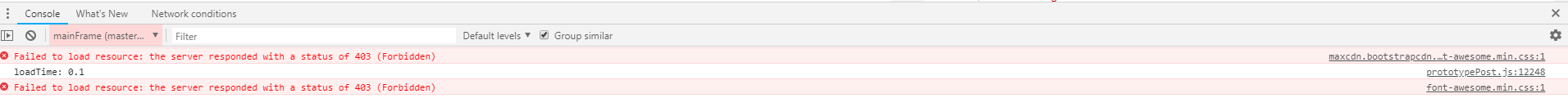

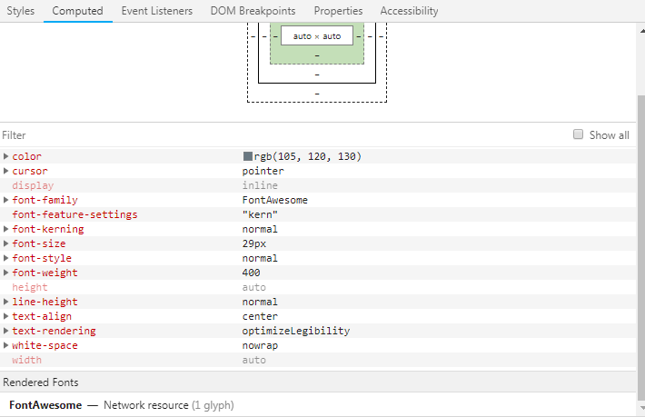

Thank you for your quick response.I have updated again this css link…“https://maxcdn.bootstrapcdn.com/font-awesome/4.7.0/css/font-awesome.min.css”. Earlier, I used 4.7. Not it is 4.7.0.
Now it should show “Network Resource”. see this screen shot. Let me check other machine and come back.
Sorry, I didn’t look closely at your URL to notice you were missing a character. But I think you should be good now!
Thank you once again. It’s working fine now.
