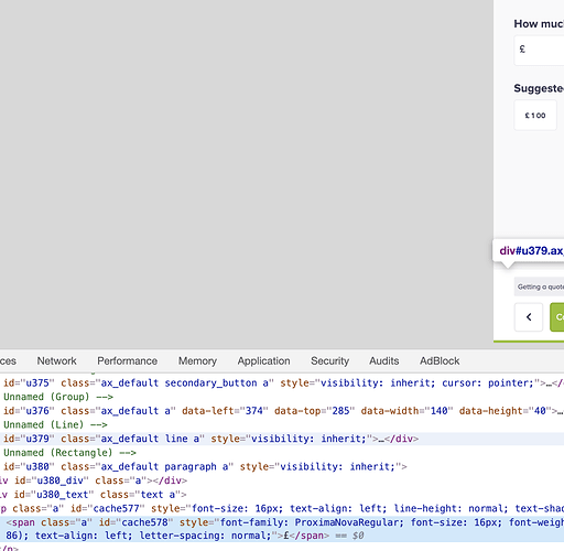

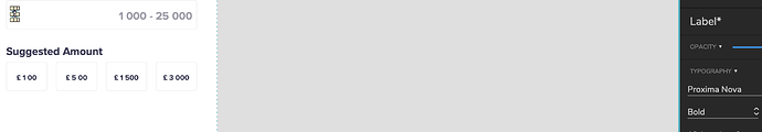

I have found a strange bug in Axure RP 9 with regards to fonts. if a text block has mixed font styles i.e. bolded words, when its rendered it doesnt always honor wha you have set. See below:
The pound sign was set to Proxima Nova Bold - and on desktop it renders perfectly.
And it doesnt want to change the font to bold - so I am now having to resort to converting to images and fonts and font styles are not being adhered to.

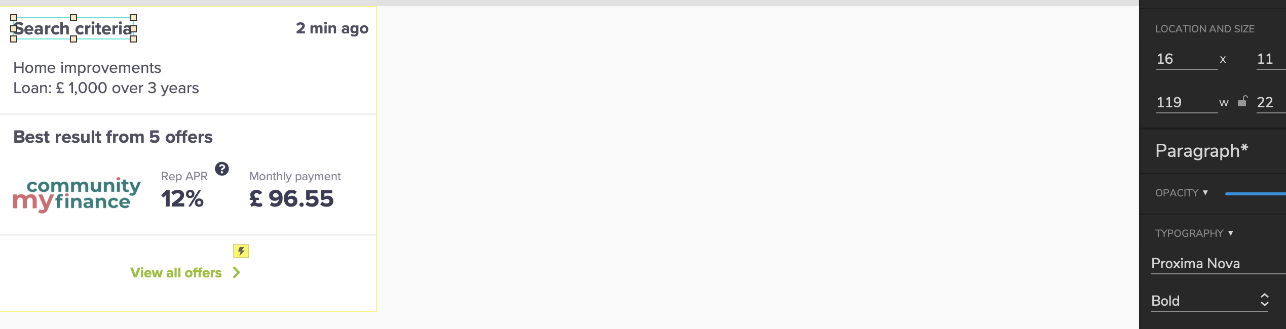

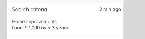

Come to think of it this does seem to happen inside dynamic content widgets. So for example I have a couple of labels inside the widget. Each label has a different font style. The bold labels seem to change to “Light” version of the font when changing to an adaptive screen although in the editor this was set to bold.
When it renders it seems to change to the light version of the font (there is no mappings setup that could affect this). When I actually inspect the element in the browser it shows a different font than what I selected.

Thank you! I was able to reproduce the issue on our end and have filed a ticket with QA for further investigation. In the meantime, while testing out your file it looks like a potential (not ideal) workaround to help the font render correctly in the adaptive views on your page would be to break away the master on the page after you’ve placed it; this removes the master+master views factor which takes the widgets out of the scenario in which the bug occurs. Hopefully that helps a bit!
No fix yet for this one, but it’s being investigated by QA! Additional details have been uncovered though that should help to plan around the issue for now; for this bug specifically, it looks like if you have font mapping applied it won’t apply to the font in masters used in a child adaptive view. Hopefully the workaround above helps, and we’ll keep investigating in the meantime!
