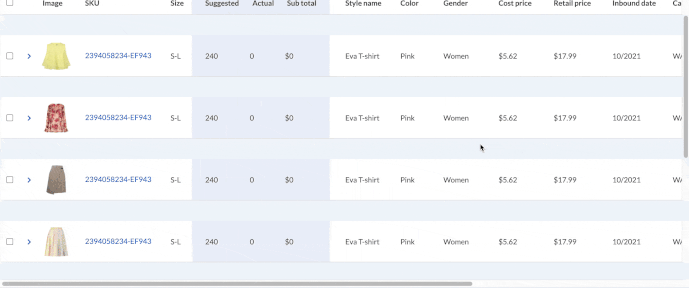

I have a repeater that looks like a normal table. I put it in a dynamic panel because I want to have a fixed area for it to appear in. However, as the repeater is very long, I want to freeze the first row and the first 8 columns on scrolling.

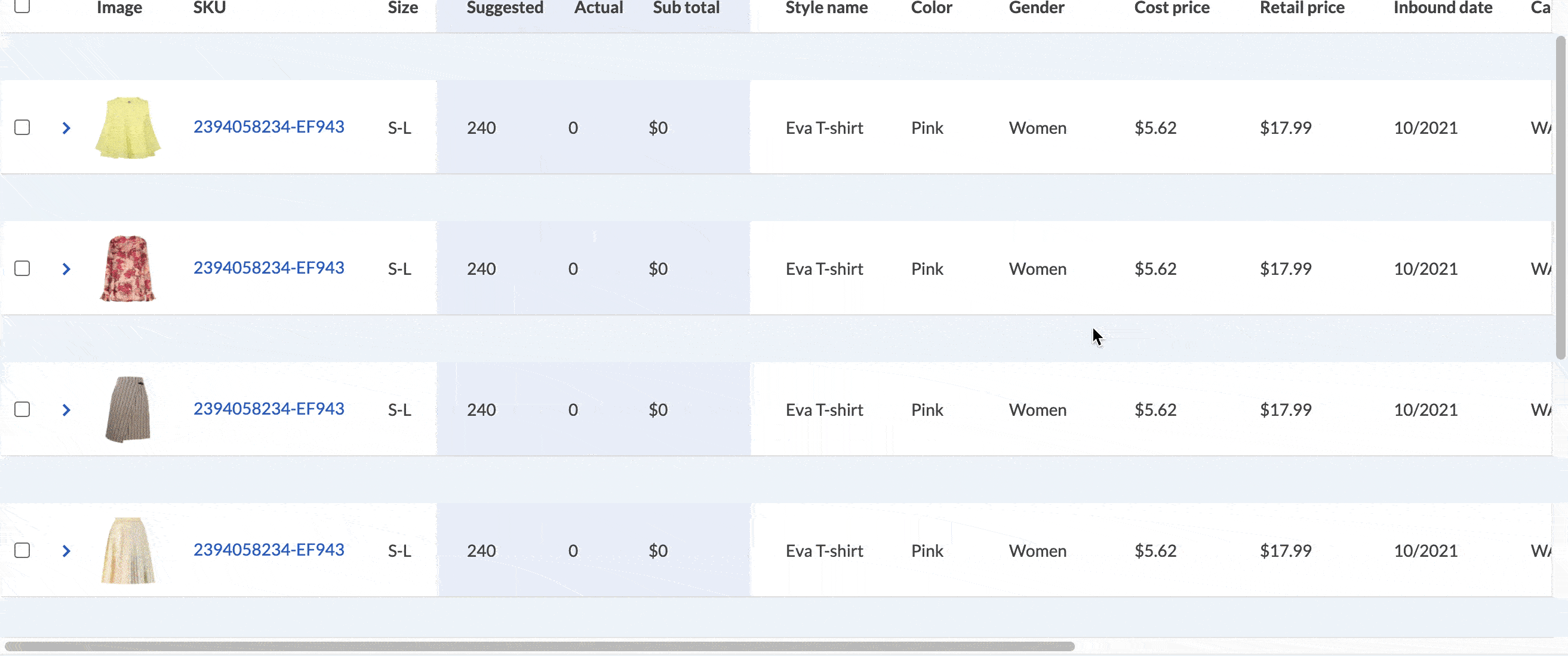

Following the method described here, I tried this: On scroll of the [table dynamic panel], move [repeater] to scroll-y of the [table dynamic panel]
But to get it to work properly, I have to move only the first row in the repeater instead of the whole thing: On scroll of the [table dynamic panel], move [repeater row1] to scroll-y of the [table dynamic panel]
Unfortunately, being new to repeaters, I have no idea how to do that. I also don’t know if moving only one row of the repeater is something that is possible. Do you happen to know if it is?
—Update—

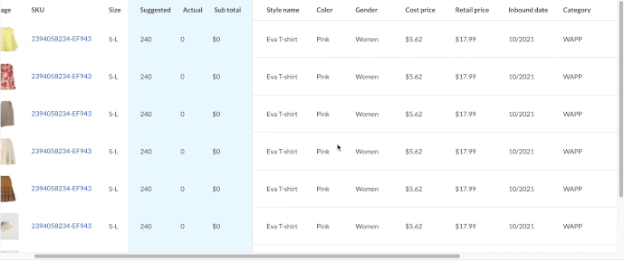

I managed to “freeze” the first 8 panels following the method above

If you can share your file…? Poss. you cannot. Bravo on the column freezing - would be interesting to see. Though notice that your fixed columns are going over your scrollable ones which may not be the desired behaviour?
