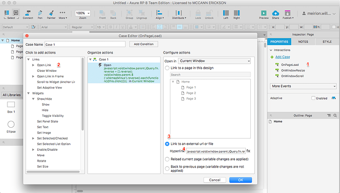

With regard to this particular feature request, check out nkrisc’s post here for a fairly simple and straightforward JavaScript workaround.
Can you explain how to add the “open” “onpageload” case? When I go into add a condition to the case I can’t figure out how to specify “Open” as shown in your screenshot.
