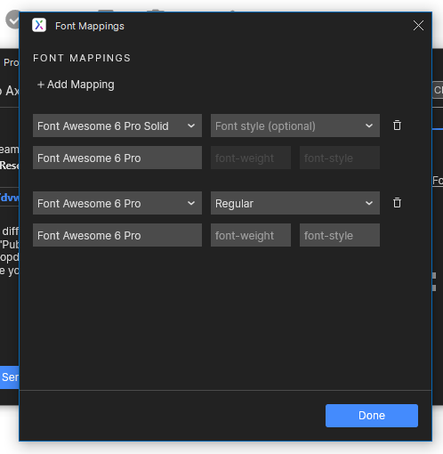

hi all,
I just wanted to close the circle on this. I found out what I needed to do in order to get the fontawesome to work. I had to include the following 2 fontmapping additions:
