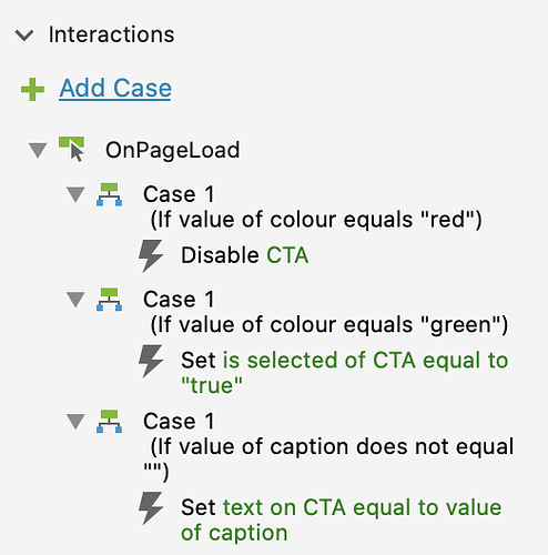

can you please put back the ability of Axure RP9 to read and manipulate global variables via the URL?
the functionality was present in RP8 and it was hugely helpful: it allowed to generate a URL with a specific prototype behaviour set by variables and onLoad conditions!!!
example here (Axure RP8): Home
will load a green button with a customised caption
will load the same button with a different colour and another caption
remove the variables completely from the URL and you will have the default status
it is a lifesaving feature: my team and I basically don’t design pages anymore but just different states of the same page (with a visible popup, without it, with a specific error message, etc.)
before we needed to create a lot of duplicate content just to simulate a simple change of status and the maintenance work required for changes was endless.
now we maintain a very limited number of “pages”
