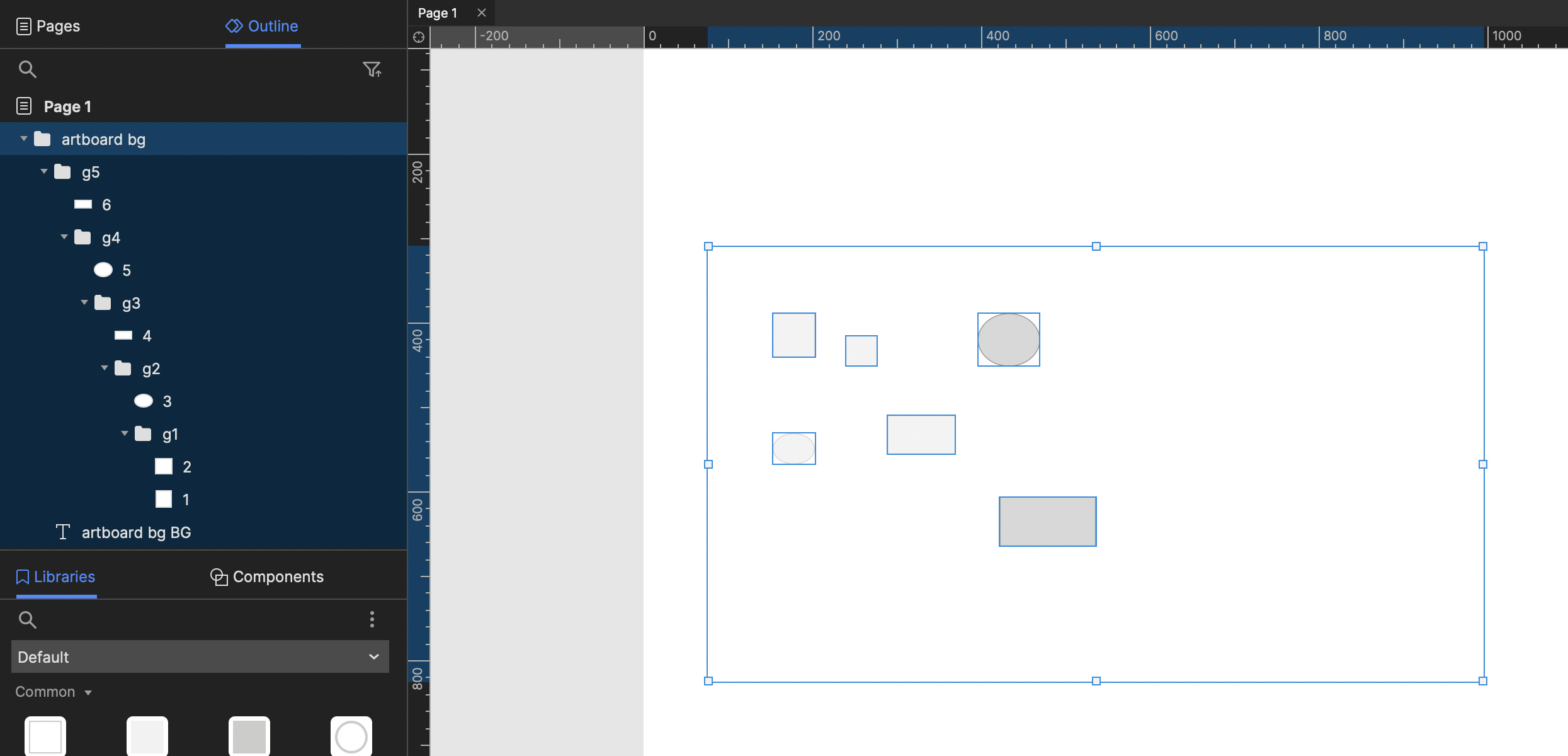

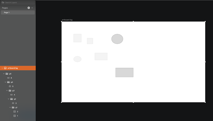

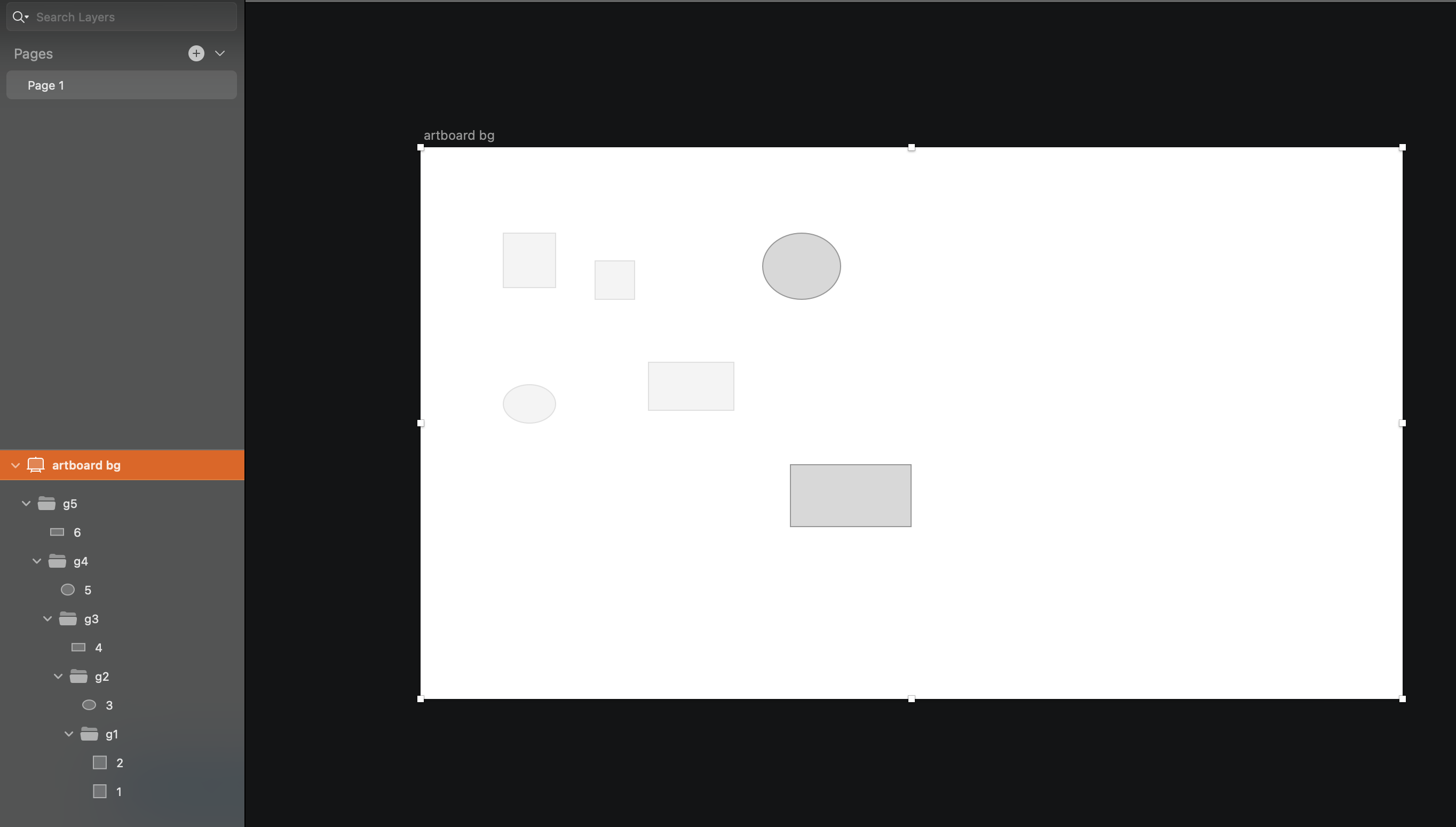

Hmm, I’m seeing nested groups carry over their names into RP. Here’s an example:
Sketch:
Axure RP:
