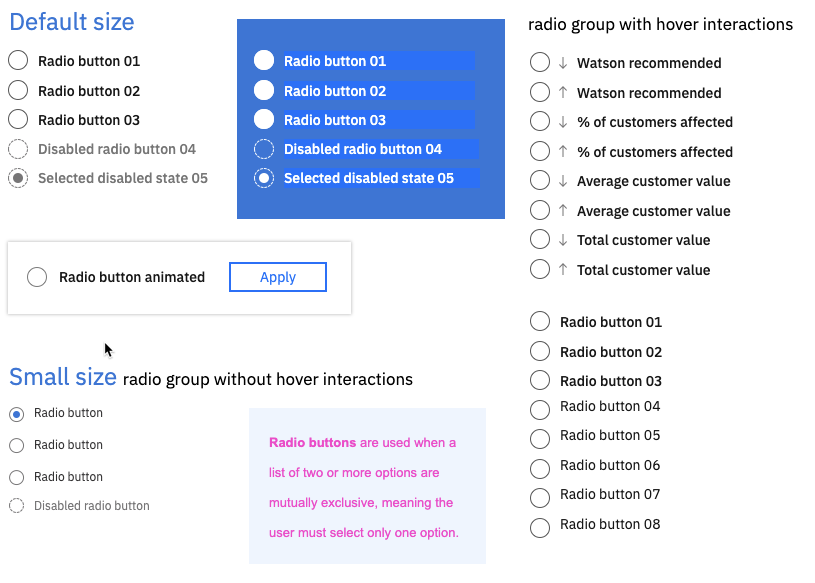

Hi jmgranger1023,
Here is radio buttons in another style that you can re-use.
I am new to Axure so I’m fumbling through. Love what it can do much more than XD which is the mode I’ve been working in. Thank you for your help. I really appreciate it! Have a great weekend!
This is absolutely awesome!!! Thanks for posting this file. It’s outstanding!
