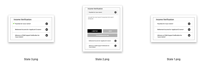

Desired action #1 (I’ve achieved this)
- On page load user sees arrow down = State 1
- On click user sees arrow up = State 2
Desired action #2 (I’ve achieved this)
- If user interacts with accordion content and successfully completes task, then when user clicks button
I’ve completed this task" show State 3 (State 1 with green check-mark)
Desired action #3 - I’m stuck
- On click user sees arrow down = State 1
How can I set the accordions to be closed (State 1) then open (State 2) then close (State 1) then open (State 2)… AND ONLY call State 3 upon button click of “I’ve completed this task”
My issue is… I can’t use “Next” because that rotates through State 1, 2 & 3. User needs to toggle State 1 & 2, back and forth.

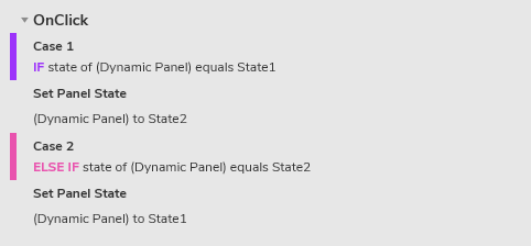

But when I’m on State 1 and I tell it upon click to go to State 2, then I set State 2 upon click to go back to State 1, State 1 changes it’s click state to State 2.
