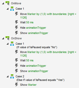

I added to the hidden shape that triggers the loop a condition to check a variable called IsPaused, but I am not sure how to set the alternate condition, for when the IsPaused value is “Yes” (where it should pause). See screenshot for that:
Unable to view v8 Beta files for the moment, but based on your image it looks as if you’ve got the right idea. Just for troubleshooting’s sake, you might try moving the “Show animationTrigger” action to OnHide event, as sometimes when you have actions that trigger near simultaneously there can be strange behaviors.

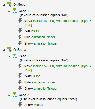

Thanks again Nathan - I solved the problem and will document it here for the benefit of future peers who run into this issue:
[ol]
[li]The first problem was that I have set an animation for the move action of the marker - it caused the entire mockup to behave strange and start with delay. Once I removed the animation and added a “Wait” action it ran smoothly and with no delay[/li][li]In order to make both the initial “Run” button make the marker progress and also the “Resume” button do the same I had to place the interaction for the trigger on both “OnShow” and “OnHide”. Not sure if this is the most elegant way, but it works :)[/li][/ol]
This is how the iteractions for the AnimationTrigger Looks now that it’s working:
