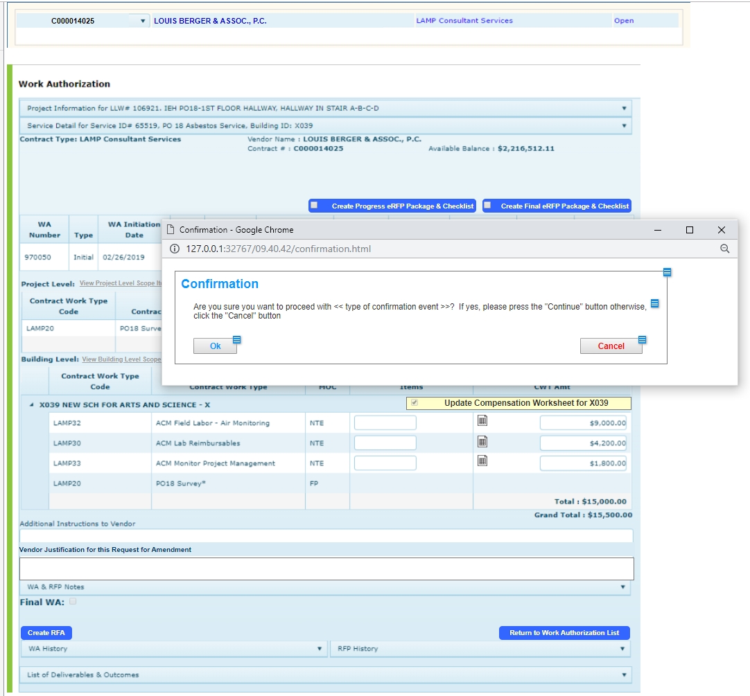

As you can see from the attached screenshots, the first one has the notes turned on both on the page and the pop-up lunched from the page.
The second screenshot should not display the notes in the pop-up since notes are turned off on the page from which the pop-up was launched.

I see what you mean. The state of footnote visibility (along with sidebar visibility/state) depends on the configuration of the prototype URL. When you view a prototype in a browser tab and toggle footnotes, that changes the URL and that change is applied to all pages of that prototype that are viewed within the same browser tab (e.g. toggle footnotes and switch pages via the sidebar). When you open a popup window, however, that window is separate than the tab that you’re currently viewing; additionally, when if you open a direct link to a page in the prototype using “Open Link to [[PageName]]” the format of the link that is opened is for the page without the sidebar, which doesn’t include information about footnote visibility. This is why if you hide footnotes in a tab and open a popup, the footnotes in that popup show. The same occurs if you turn off footnotes in one tab and open a link to a page in another tab; the new tab opens with the format prototypeurl/pagename.html, which has the sidebar hidden and no information about footnote visibility, so footnotes in the new tab would be turned on.
