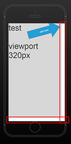

@Gregor I tried your solution but found that the very bottom of my content gets cut off, and it seems the amount that gets cut off is exactly the size of the horizontal scrollbar that would be on the bottom.
This workaround doesn’t work anymore. The cropped dynamic panel is visually expanded by the width, the visible scrollbars would have, without showing them but showing only white space.

I faked the mobile devices within the rp file (please click on the pink icon, the page will reload in a new tab) - i am looking at it in the chrome browser.
Thanks for sharing your RP file! What’s strange is that I was only able to reproduce what you were seeing (your screenshot) by previewing the page on my external monitor, rather than my main MacBook display. When viewing on my main MacBook display, the iframe was contained inside the dynamic panel container. When moving the previewed page to my external monitor, however, the iframe resized to its actual size, rather than the size of its DP container. It looks like this is specific to Chrome - i.e. I’m not able to reproduce this in Firefox or Safari - and I’ve filed this with our QA team for further investigation.
In the meantime, one workaround would be to remove the iframe and instead use a dynamic panel with scrollbars to wrap the content. Then, encompass the DP into another DP and resize the outer DP to hide the inner DP’s scrollbars. Another alternative may be to view the project in another browser other than Chrome.

I’ve tried with a nested Dynamic Panel. I have 2 dynamic panels. The deeper one with my content and a DP above, reduced in size. That’s ugly and dirty but it works. (RP9)
