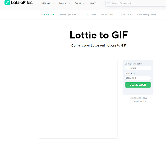

Hello, it is an interesting alternative with Convert Lottie to GIF – free online converter – LottieFiles, which converts the Lottie json file to gif, so you just have to have the json file of your Lottie animation and you can easily convert it in gif and then use it in your RP file
Lottie-Gif.rp (321.0 KB)
Thanks a lot Serge!
I was sceptical a gif file file will look good, but this convertor does a a really great job.

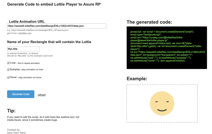

I am happy to share that I figured it out (with a little help of ChatGPT that debugged my code :sweat_smile:). I created a file with a code generator - simply paste the URL of the Lottie file from lottiefile.com, and get the script.
There are also several examples how to use this script. Embed Lottie Player in Axure RP.rp (89.4 KB)
