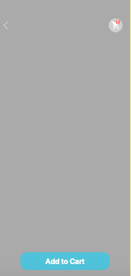

I’m working on a prototype of an ecommerce application
where there is an “add to cart” feature where when the button is clicked, a round notification will appear above
Like this picture
maybe anyone can help me?
addtocart.rp (46.6 KB)
You can do this quite easily using ‘Show/Hide’ interactions. Group the elements that make up your notification badge, give them a name, then hide them (the eye symbol in the toolbar). Then add an interaction to the ‘Add to cart’ button that will show the badge.
