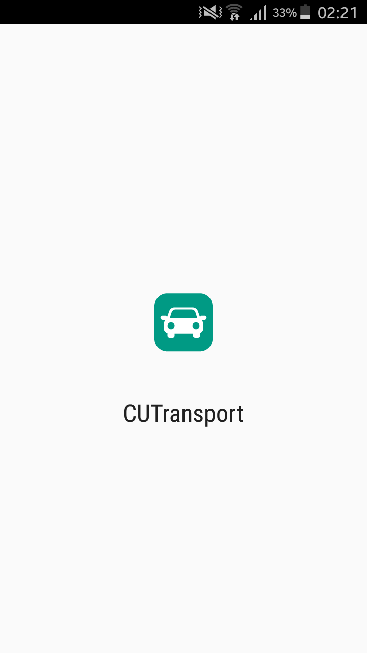

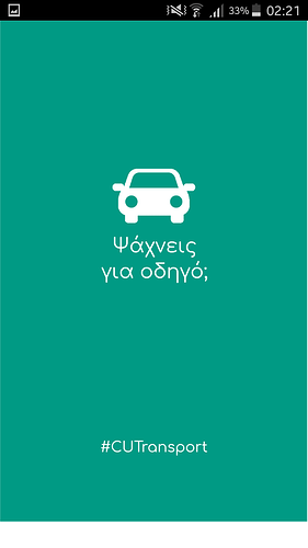

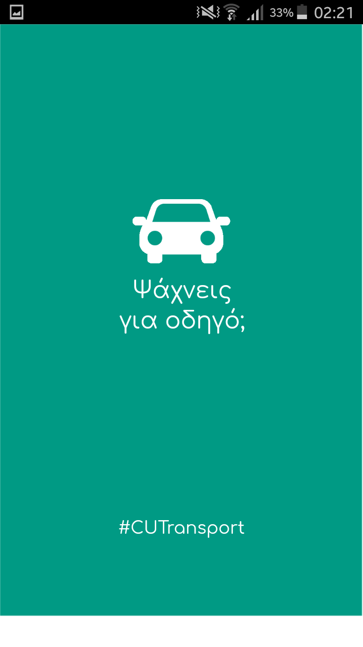

After tap on app icon, I would like to load my first page which is the one with the green background. However, the initial page is the other one. What can I do?

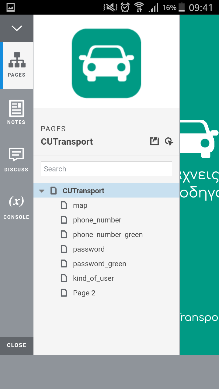

Here is my sitemap
It is automaticly loads a page that I didnât put which is the one with the white background and then loads my original first page.

I mean that the certain page it doesnât exist on the sitemap. It is loaded automaticly after tap on app icon and the page that is loaded after that is my first page

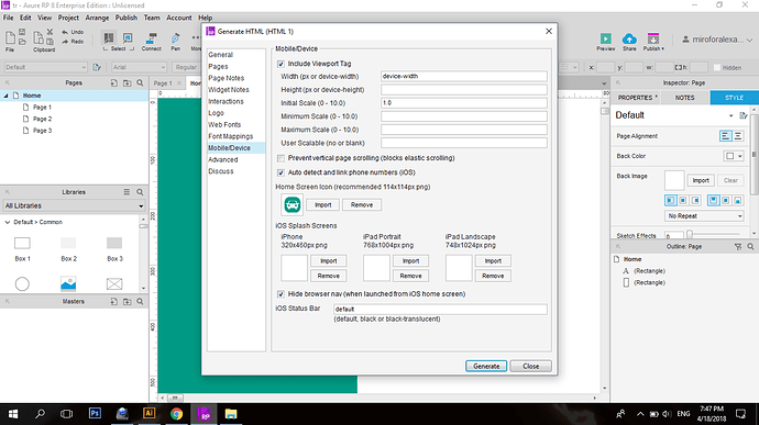

Did you add a splash screen under the Mobile/Device settings? Go to the Project menu, then Generate HTML Files⌠then Mobile/Device.
Itâs also possible that itâs Android doing it automatically, did you save it to the homescreen?
I didnât add a splash screen. Here is a screenshot of Mobile/Device settings
Yes, I have added it to the homescreen
Then I believe that the Android OS is adding it and not Axure. I donât know if thereâs a way to avoid it, some research might be needed.
