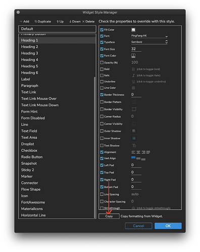

How does one paste style after copying it?
You’re in the styles manager. The button you’ve highlighted will update the selected style (Heading 1 in your case) to match the styling of the selected widget. The format painter is an option in the toolbar (atleast in 8) I’m not sure about 9 as I haven’t upgraded…
