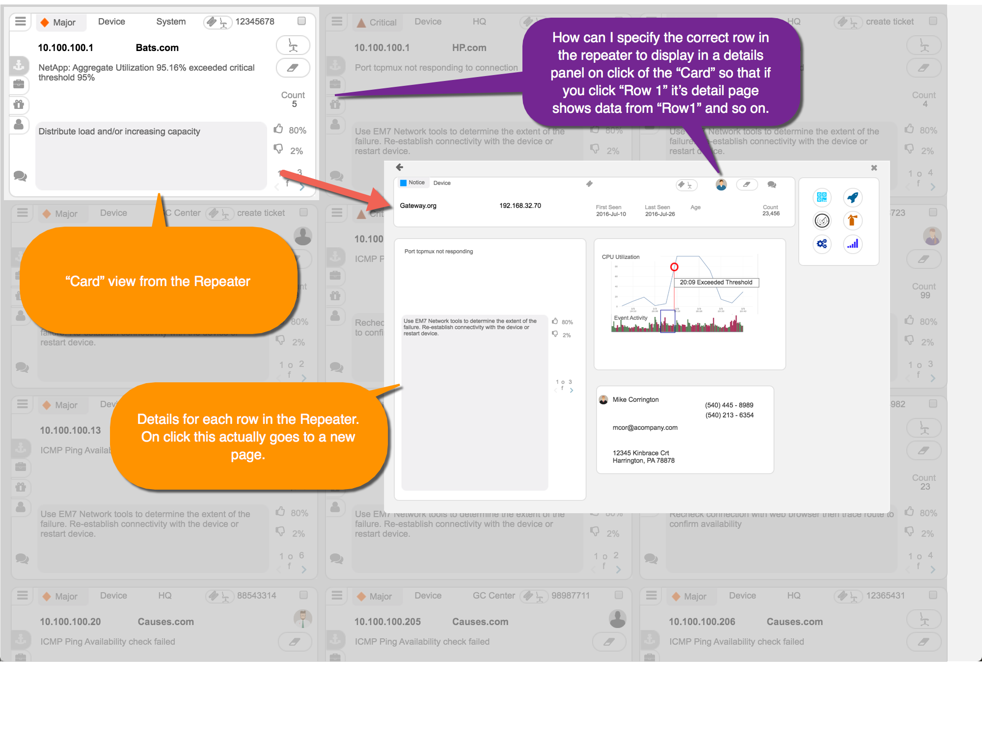

Hello,
I’m sure others must be doing this, so hopefully this is an easy one. I need to have an “Onclick” action where, upon clicking a repeater row (displayed as “cards”) takes you to a “more details” page.
Everything works, except I can’t tell Row/Card #1 to display the details for Row #1 in the “more details” page. I need to display the correct detailed information for each Row/Card.
(Just refer to the most recent image - there is no way to remove a previous image)
[ATTACH]11012[/ATTACH]

Thanks mnearents. I have already set all of the data points to be pulled from the repeater, my problem is I don’t know how to tell the details page (it’s another dp that replaces the card view where the repeater lives) which row it is. I know that card #1 is Row #1, and Card #2 is Row #2, but I don’t know how to specific that in an “Onclick” event. Perhaps a filter would work where I could set it equal to [[item.Index]]. ??

Yes I have all of that working, but the main difference is the Onlick action I need is:
- Click an item on the repeater row (that is inside of the repeater) that opens a new dynamic panel that is completely outside of the repeater. In that new dynamic panel, display the repeater data for that row.
I have all of it working EXCEPT it doesn’t know which row data to display so it just displays the last row of the repeater.
I want it to know that I clicked on row 2, for example, so it displays row 2’s data in the new dynamic panel that is outside of the repeater (but still on the same page).
It’s your basic drill down from a list of things, like for example, when you shop on ebay, you have your list of matching items, then you click that one item and you get all of the details and actions for that item.
Hopefully I’ve explained it better this time.
OK! I see what I did wrong! I didn’t put the mapping in the “Onclick” action - I only put it on the “OnItemLoad” function.repeater onclick-ms.rp (74.7 KB)
