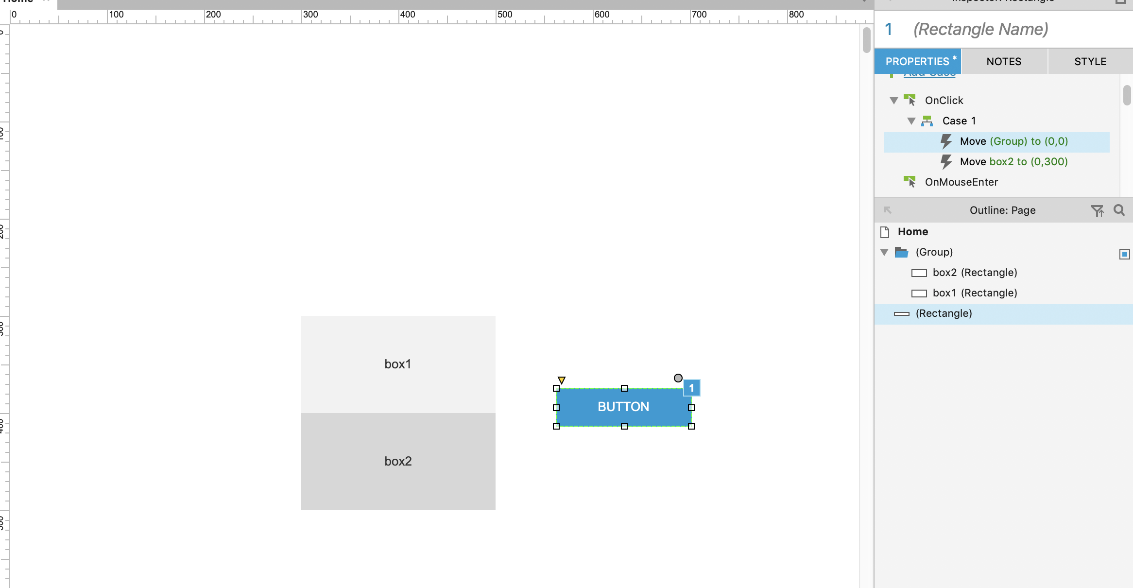

Hi there, let’s say that I have 2 boxes: box1 and box2, and I make them a group. There is also an button, I set the OnClick event as in the picture, and please notice that annotation is none now:

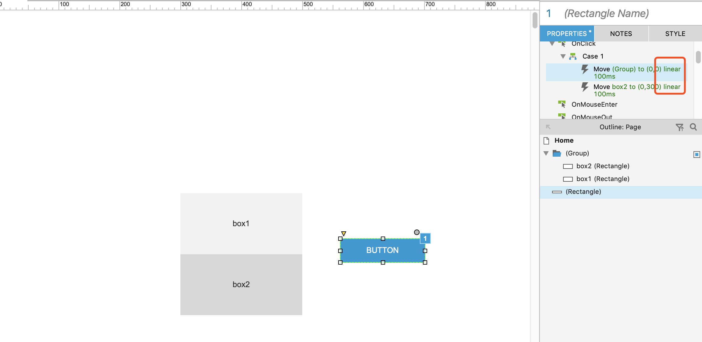

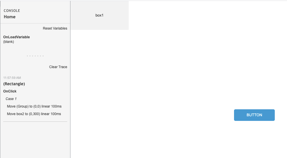

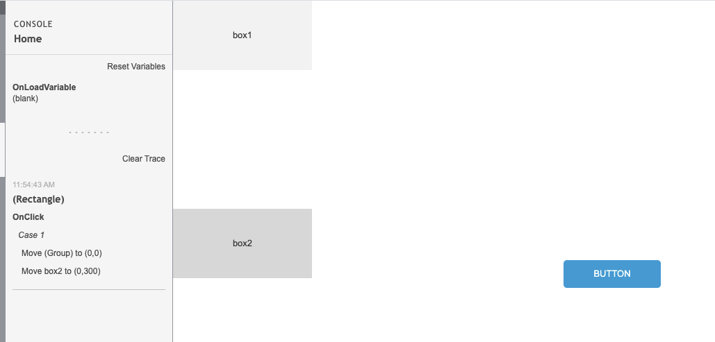

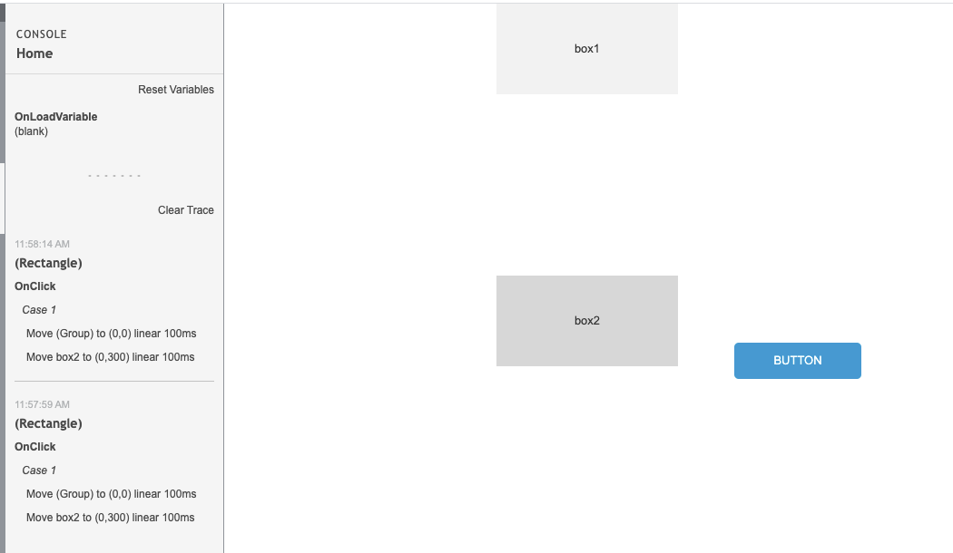

You can see that the location is totally different. I don’t see why different annotation makes such big differences. Please give some explanation. Thanks!
Try ungrouping the boxes and just handling them separately. Since it works without the linear animation, you could try adding a Wait 150 ms (or some time equal or greater than the animation (“linear 100 ms”) action after you move the group.
However, there is a known bug with moving widgets in a group (recently fixed in Axure RP9.) If you need to treat them as a unit (e.g., "Move group to (0,0), then ungroup them and place them in a dynamic panel (select both widgets, right-click this selection and choose “Convert to Dynamic Panel”.
