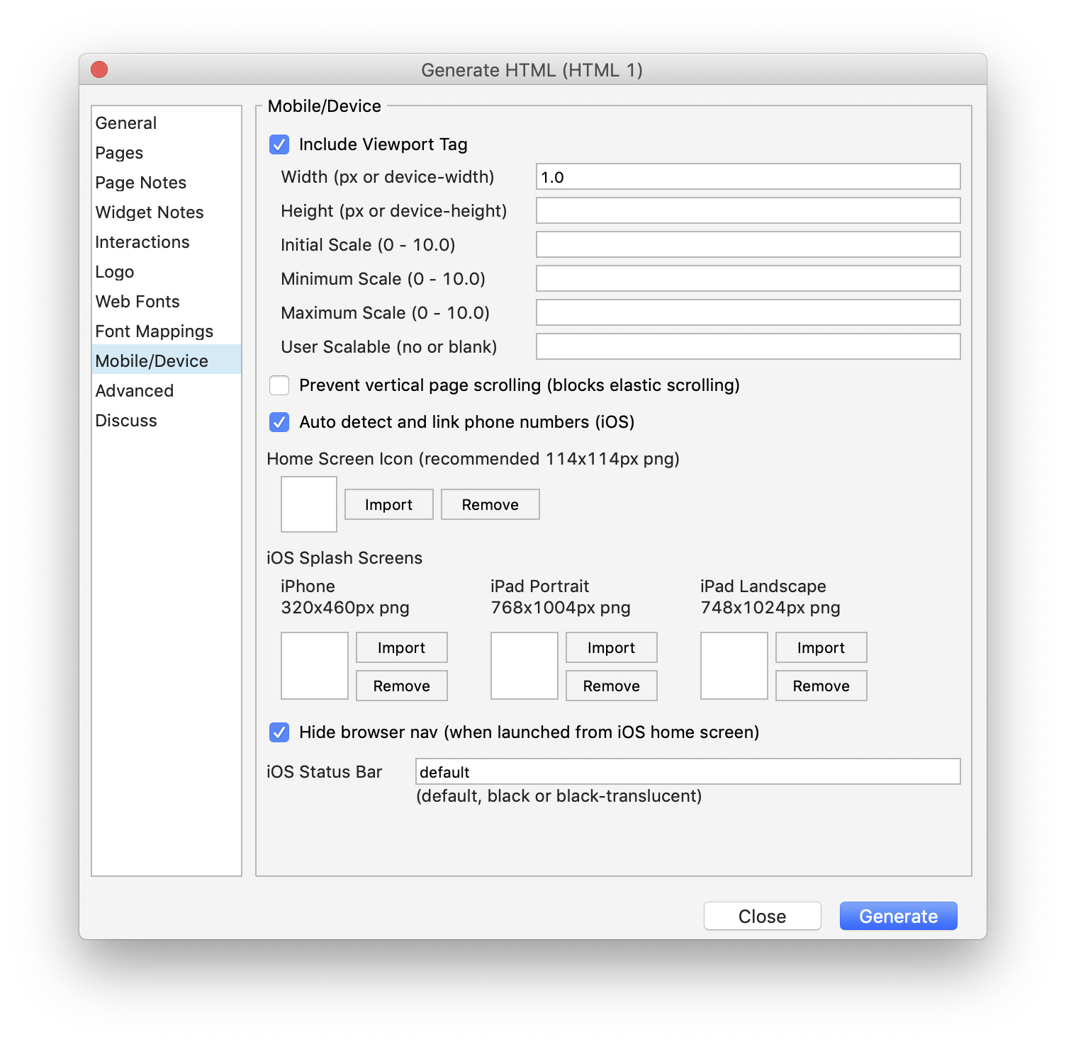

Have you tried including the viewport tag (Go to Publish > Generate HTML Files > Mobile/Device (on the left menu)?
This image have the settings that worked for me.
Hi there. I’m using Axure 9 and the viewport setting is gone along with those scales. I got it to work by removing all adaptive views and going with the “auto” setting for the pages. Guess the mobile phone sizes don’t actually work for mobile phones?
