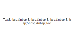

So tried to make a general function that would allow me to type special chars instead of the actual chars. [[this.text.replace('◌',' ').replace('⁞','<wbr>')]]
Than it fails for me.
So then i typed my text like this:
Red# #Cross is a non#­#profit organisation.
(this looks terrible, but its is a try…)
With replacement code: [[this.text.replace('#&','&').replace(';#',';')]]
Also fails (although initially it seemed to work, i don’t know why).
Hmm, you should be able to insert non-breaking spaces while editing text. Would you be able to post an .rp file of where you’re running into this issue? The .replace( , ) method with an OnLoad seems to be working on my end as well. Also, please let me know the version of Axure RP you’re running (e.g. 8.1.0.3366), as well as the browser you’re using to view your prototypes. Ty!
