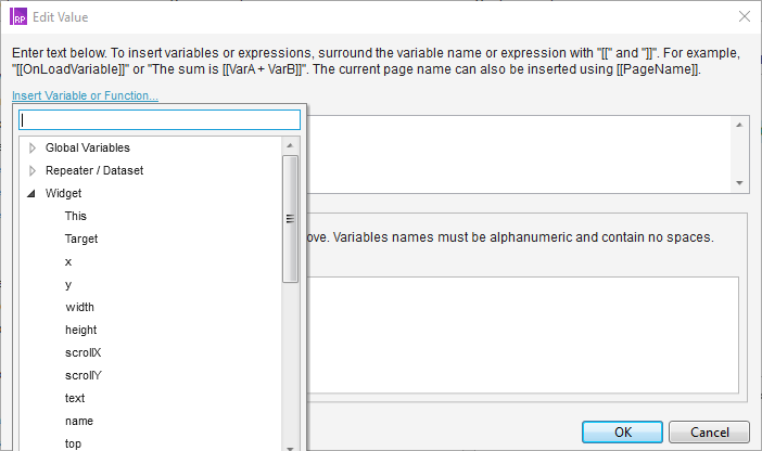

is there a link to a good reference on Axure that explains these kinds of things clearly or a link that defines each of the functions and how they work?
You’re so close. [[bar.x]] is right, except you can’t just directly reference widgets by name because widget names are not unique. Instead hit the fx button next to the field and in the bottom half of the expression editor that opens add a new Local Variable. You can name it bar and then in the drop down next to it choose Widget and then choose which widget. Now in this expression only (the local part) bar will reference that widget and you can access its x and y properties.
