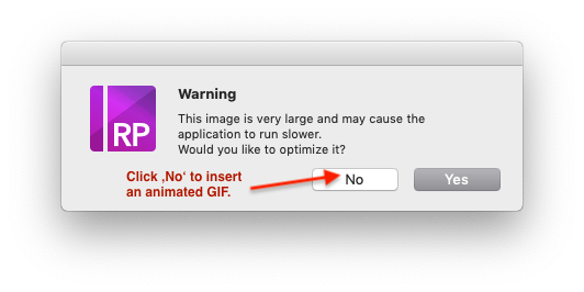

Here is my Gif and it does not move and is really confusing me…can you possibly tell me what I am doing wrong? It is a video gif that I have downloaded and no other gif moves. Will upload file too.
Hope you can advise: Daryl (thanks too!)Barking Mad.rp (89.3 KB)
Hi @daryl_lee,
when you drag ‘n’ drop an image in your Axure-file an alert informs you if you like to optimize the image. You need to click ‘No’ and it will include an animated GIF in your file.
Hmm, the gif works on my end without issue as long as you do not optimize it when you import it into Axure RP. The gif will not animate on the canvas, but you should see it animating when you view the prototype in the browser. If you’re seeing that it’s not animating when you view the prototype in the browser then please attach the .rp file and we’ll take a look. Thanks!
