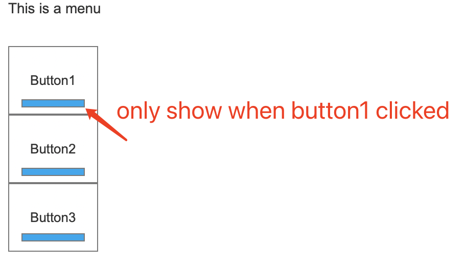

So I try use dynamic panel to realize it, but when I click by this order, it won’t be work:
Button1, Button2, Button3, Button2
It seems when I click button3, panel container cover Button2, so I can’t click Button2 more.
Now I want to ask how to realize it, whatever use any way.
