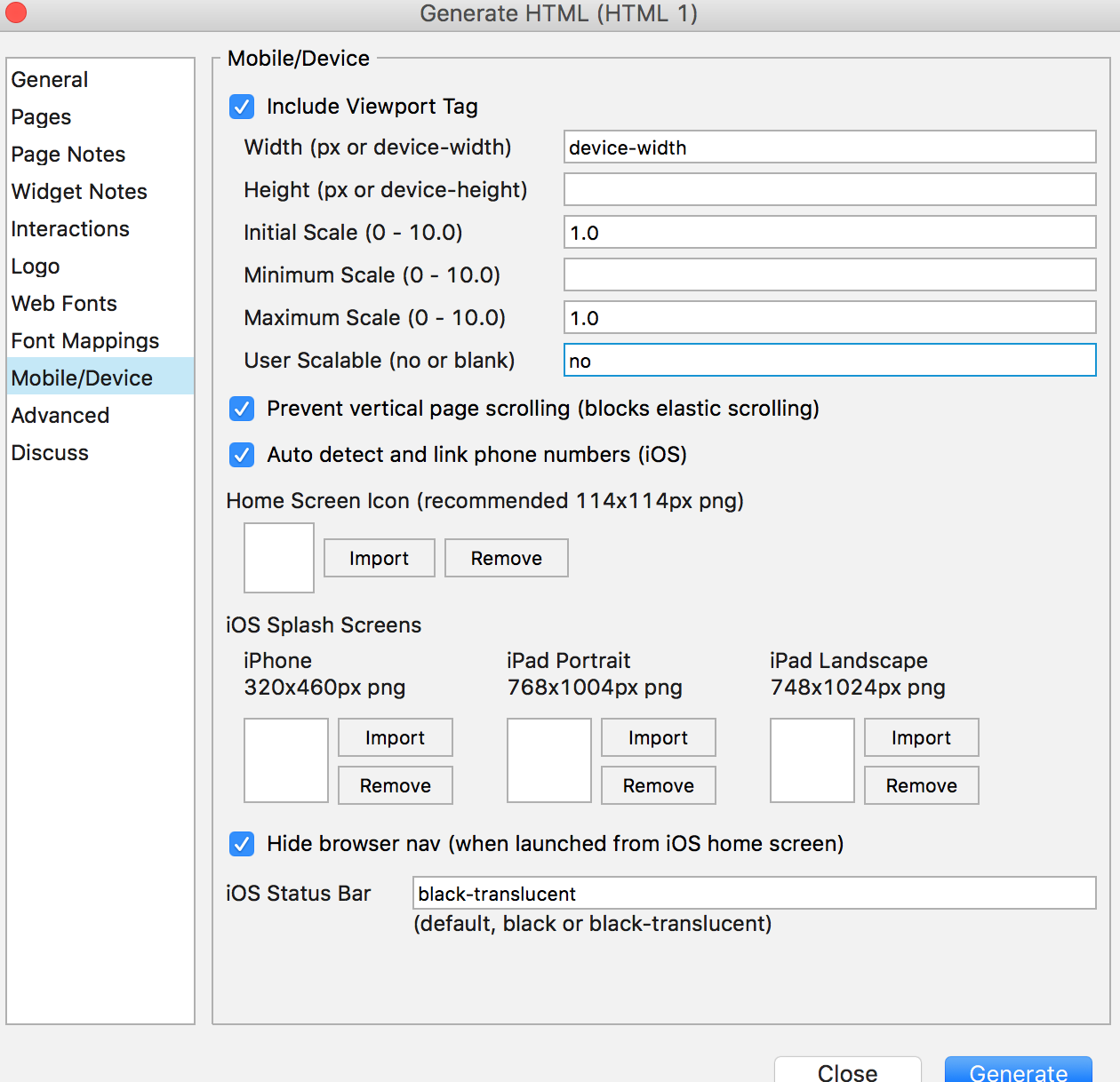

I’m working on a mobile application prototype. I’ve been using the Axure Share application on iphone 8. Even though I have the prevent elastic vertical scrolling checked in the project settings, this is still occurring. It really takes away from the mobile app feel. Is there script or an alternative to fix this or maybe a different setting?

We do have a bug report on file where selecting the “Prevent vertical page scrolling (blocks elastic scrolling” checkbox will freeze the entire page, i.e. there is no elastic scroll, but the ability to scroll in general is gone. If this is what you’re experiencing, what will help is to use the OnDrag or OnSwipe events with the Move to/by interaction to move the content, rather than depending on mobile scroll. Please note that the OnDrag and OnSwipe events are only available with dynamic panels.
If you’re seeing otherwise, is there a chance you’re running an iOS later than 11.2? I ask because I’m seeing on my iPhone (running 11.4 beta) that selecting the “Prevent vertical page scrolling (blocks elastic scrolling)” will not freeze the page, but the elastic scroll is also very apparent. That is, this setting breaks entirely on my phone. If this is what you’re experiencing, we have this filed with our QA team as well, and I’ll make a note to the case to let our QA team know that other users are running into this issue.

“Prevent vertical page scrolling (blocks elastic scrolling)” is DEFINITELY checked however elastic scroll is very apparent. Up/down scrolling works normally.
