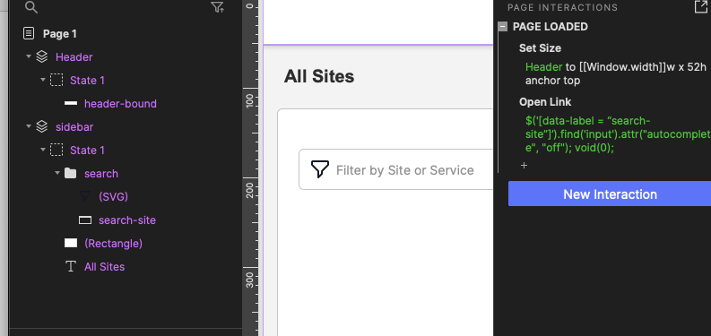

Funny, I just ran into this issue yesterday. You can stop a field from doing this with a little javascript. The hack for adding javascript is to put it into the external-URL field of the Open Link command. (A link won’t open.)
Place the following into that field instead of a URL. It assumes your field is called “mySearchField”. You could add this Open Link command to OnPageLoad
javascript:
$('[data-label = "mySearchField"]').find('input').attr("autocomplete", "off");
void(0);
you are a genius, thanks!

You miss
javascript:
Thank you Jorkin!
You’re the best!
