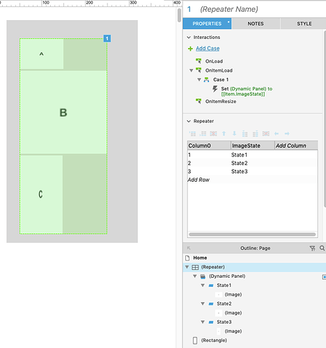

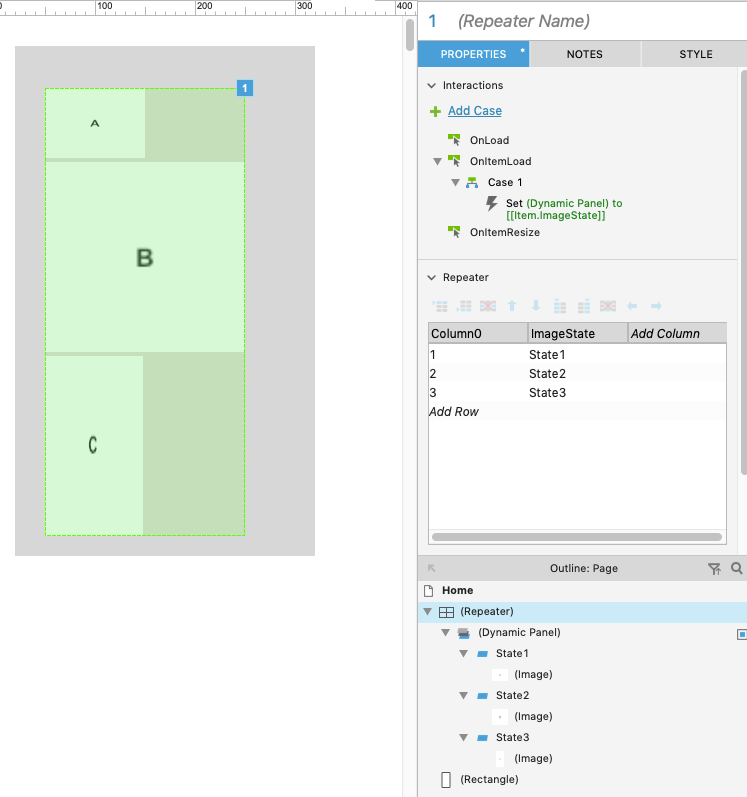

You can have your repeater rows dynamically resize to the size of your image by placing your images in dynamic panel states and having your repeater rows load in the different states. To do this, you would create a dynamic panel that uses Fit To Content styling. You would want to place an image widget in each panel state, and then import the varying images into the different states.
Then, you would want to create repeater data that tracks the name of the dynamic panel state that contains that row’s image. If this repeater data is identical to the name of the dynamic panel state, you can use an OnItemLoad action to set the dynamic panel to the state of the repeater data. For example:
Because the dynamic panel is set to fit to content, and the images are of varying sizes, changing the panel state OnItemLoad loads in the differently sized images.
Please feel free to take a look at this sample file as well.
Repeater Set State sample.rp (52.3 KB)
I hope this helps!
