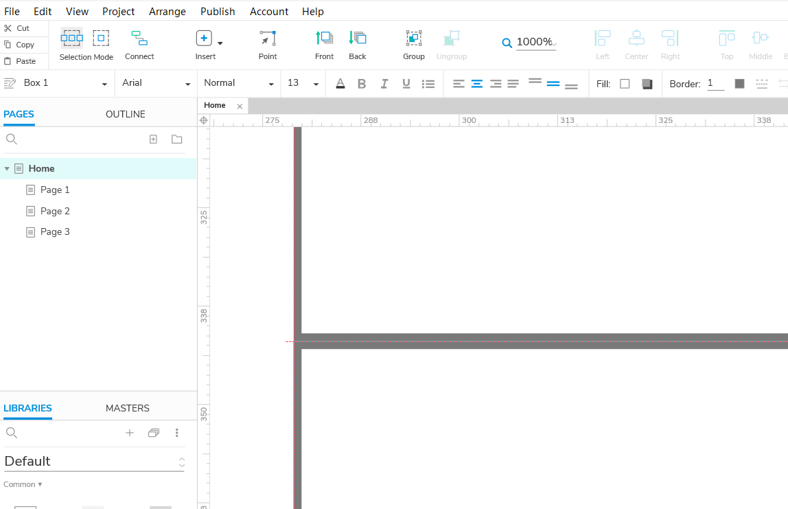

Hi afei929,
This feature pertains to the way that borders render on widgets, rather than their behavior in interacting with other widgets. It looks like you might be showing two widgets in your screenshot?
Hi Rachel,
Maybe I have misunderstood this feature. Thanks for your reply.
为什么要删除呢,在Axure 9中两个控件之间贴合之后会有2像素,这个体验很不好。
这个只能通过隐藏边框来解决了…就是比较麻烦一些
