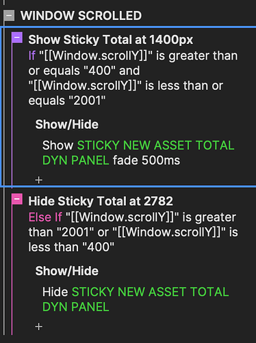

The issue is that I can’t use something like:
(text value) [[Window.scrollY]] is greater than or equals (text value) 400
and
(text value) [[Window.scrollY]] is less than or equals (text value) 2001
because when I change the screen resolution and preview it, stickyTotal shows and hides in the wrong place. In other words, I designed it in 1920 x 1200, previewed it, and it looked great. I then changed the resolution to 1440 x 900 and it showed too soon and hid too soon (i.e. too high up the screen in both instances).
I need it to show and hide in the same place regardless of the user’s screen resolution, something that scrollX and scrollY don’t seem to account for. They should be resolution agnostic but aren’t (rather, I want them to be!
(Ignore the “at XXXXpx” bit in the Case titles in the image below. They’re irrelevant now.)

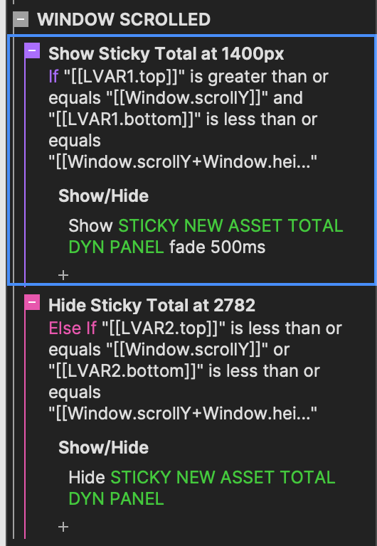

Then, following @josephxbrick’s advice in the thread Edit element when it gets scrolled into viewport, I tried to set a local variable LVAR1 = widget “Equity input field” and used the top and bottom of LVAR1 to show and hide like this:
(text value) [[LVAR1.top]] is greater than or equals [[Window.scrollY]]
and
(text value) [[LVAR1.bottom]] is less than or equals [[Window.scrollY + Window.height]]
(Again, ignore the “at XXXXpx” bit in the Case titles in the image below. Still irrelevant.)
but the problem with that is that stickyTotal never hides when you scroll back up (among other things) because it’s looking only at LVAR1.
