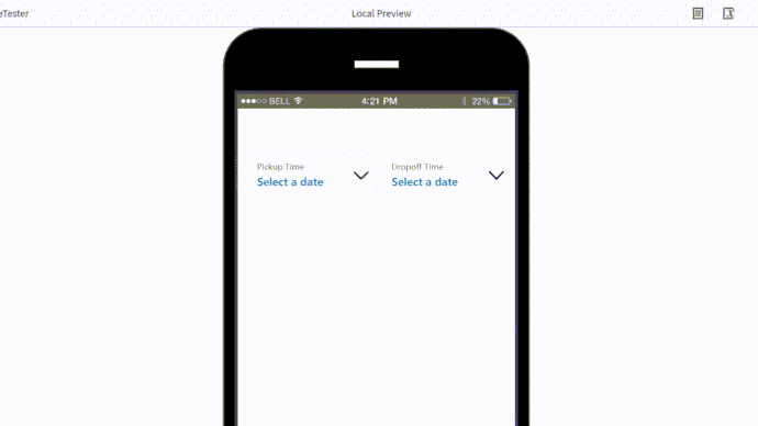

Here I got two sections, Pickup Time and Dropoff Time. The main thing that I wanna solve is to turn the arrows when they are selected immediately without closing the sections individually.
Take a look at the “TimeTester (1)” page of this updated RP file: cloneTester.rp (2.1 MB)
