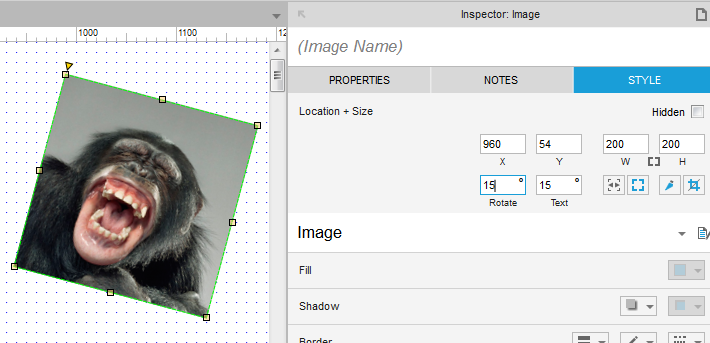

I started by dragging an image widget on the stage and loading a picture, then set its initial rotation to 15 degrees:
