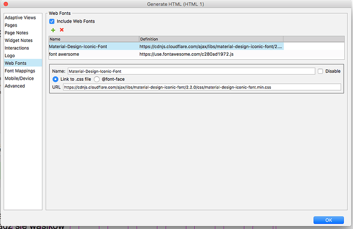

You need to set it up as a web font in your prototype.
Good to see you again Sir. Basicaly I would like to add this font : Material Design Iconic Font by zavoloklom

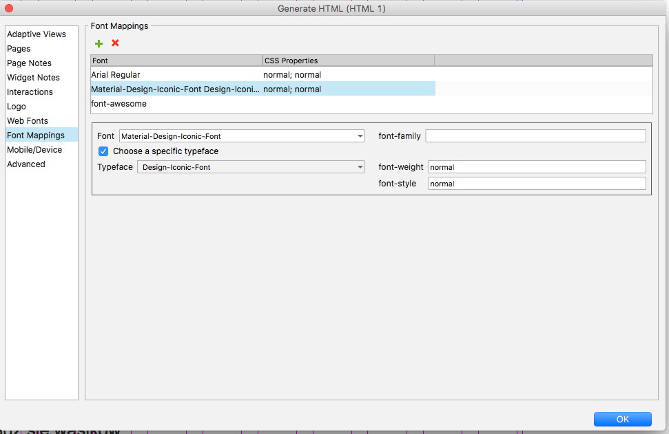

Problem is I using your solution but this doesn’t work for this library. Maybe I doing something wrong. Here are my settings :

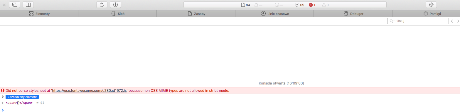

Oh sorry In console. I found something …

Hmm, it looks like you set up a font mapping entry for the Material Design Icons font, but didn’t map it to anything. Does removing that font mapping entry do the trick to allow those Material Design Icons to render correctly instead of as boxes?
Regarding the console error, it looks like you may have put a .js link instead of a .css link in the web fonts tab for your Font Awesome font. Which version of Font Awesome are you currently using in your file? Is it 4.7? If so, and if your current fonts aren’t working, then please try using the assets from the link below to ensure that you have matching versions of the widget library, font file, and CSS link:

You are amazing Allysa ! Always !! It works when I remove that mapping entry but still my Arial font looking like Times New Roman, how can I change it ?
You also have a font mapping for Arial set. Is that also set to nothing?
That was disaster :smiley: Thank you Guys !
