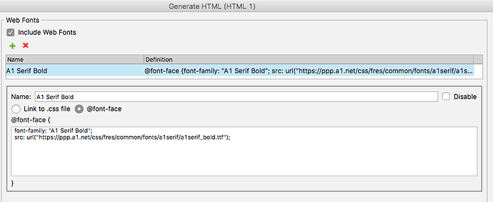

I’m struggling with the integration of self-hosted webfonts. Here’s how an example page looks like in Axure (the webfont “A1 Serif Bold” is installed locally on my Mac):
Inspect the text in question in the browser. What font-family value has been applied to the text in the CSS generated by Axure? Make sure it matches the font-family name you defined in the @font-face settings.
Are there any errors in the browser console? Is the request for the font successful?
EDIT: Saw your link after I posted. It’s number two (look at the browser console). Your server is not responding with the font file because of the CORS settings on your server. You’ll need to modify your settings to allow the axshare domain.
.htaccess is the configuration file for Apache web servers. Assuming you’re using Apache as your webserver, you need to edit that file to allow cross origin request sharing for your font file. Be careful though, you can easily make your server insecure if you don’t know what you’re doing. I would do some reading first before you change anything.
