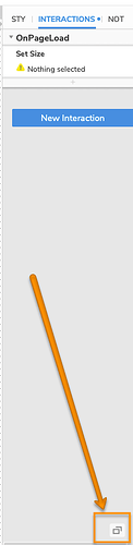

I wanted to let you know that I’ve been able to reproduce this issue and I’ve gone ahead and filed a bug report with our respective teams regarding this behavior. While this issue is being investigated, please feel free to try using the new Interaction Editor, which can be accessed by double-clicking on an interaction or by clicking on the Interaction Editor icon found at the bottom of the Interactions pane:
