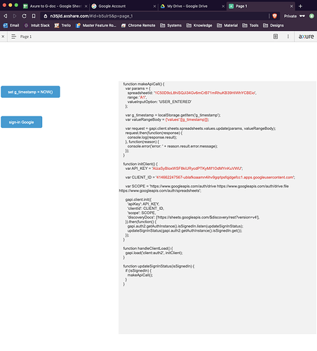

I’m no expert to Javascript, this is what I can do at the moment.
SendValueToGSheet.rp (53.5 KB)
PURPOSE

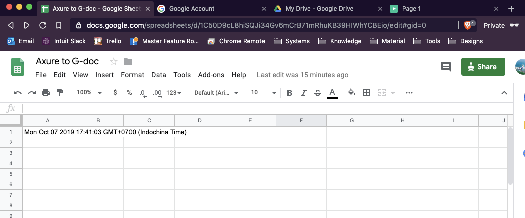

- set current timestamp to G-sheet A1 cell
REFERENCES & SYSTEMS
- https://developers.google.com/sheets/api/reference/rest/v4/spreadsheets.values/update (how to implement)

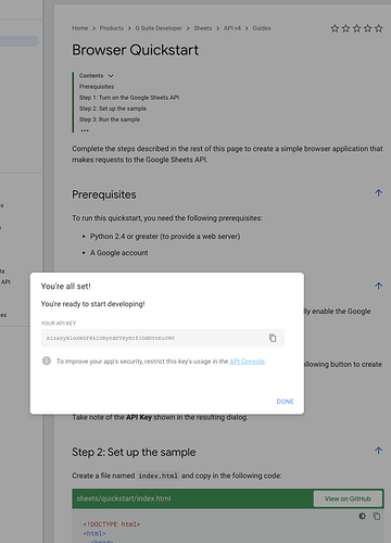

- https://developers.google.com/sheets/api/quickstart/js (generate client id & api key)
- Google developer console: https://console.developers.google.com/apis/credentials
- G-sheet to write into: https://docs.google.com/spreadsheets/d/1C50D9cL8hiSQJi34Gv6mCrB71mRhuKB39HIWhYCBEio/edit#gid=0
- Published example: https://n35jld.axshare.com/#id=b5ulr5&p=page_1
STEPS
- set your browser to allow all cookies
- generate your client id & api key
- publish this Axure project to cloud (can’t figure out how to make it work with localhost preview), note down the URL
- go to developer console, add top level domain (axure.com) into whitelist, also add this project URL into Authorized Origins
- Create a g-sheet to write into
- Modify the code, the red highlight ones are required a change
– spreadsheetId : the id in the g-sheet url, 1C50D9cL8hiSQJi34Gv6mCrB71mRhuKB39HIWhYCBEio for this example
– range: the cell range you need to write into
– valueRangeBody: the data you need to write into, please find “how to implement” for the format
– API_KEY : your api_key
– CLIENT_ID: your client id - Inside the Axure page, (i’m not making it perfect so the workflow sounds a bit weird). You need to
– click the “set g_timestamp = NOW()” button
– wait for around 5 seconds for the background requests complete
– click “sign-in google” button, then if everything is configured correctly, you will see the popup dialog as you to grant permissions
– finish granting the permissions
– click “set g_timestamp = NOW()” button again
– the value should appear in the g-sheet
