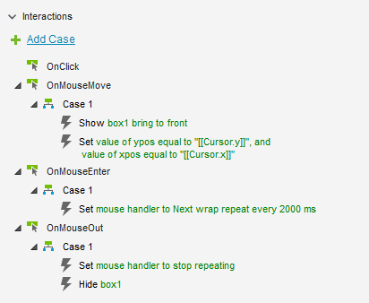

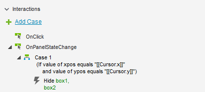

OK, what about this?
The code for the boundary box is:
The mouse handler:
So, as the mouse cursor moves within the boundary box, the x and y location of the cursor is tracked in two global variables. If the mouse moves fast enough, these two values will be different. It turns out you have to move the mouse very slowly to not trigger this (unless maybe you have a hot gaming system?) But, the slower the mouse moves the more likely some blinking will occur.
Another problem with this approach is the 2 sec delay after the cursor stops moving is not guaranteed. You can increase the auto repeat time for a “usually” longer delay. Also, if you move cursor over the special widget, it will blink sporadically.
