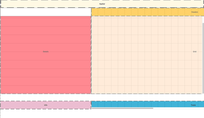

Some captions to illustrate my case:
View of the layout when the page loads. Everything looks and behaves as expected.

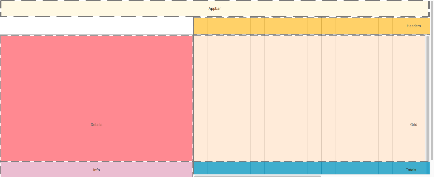

When the page is made shorter the vertical scroll in the grid kicks in, just as expected (enlarge picture to see scroll).

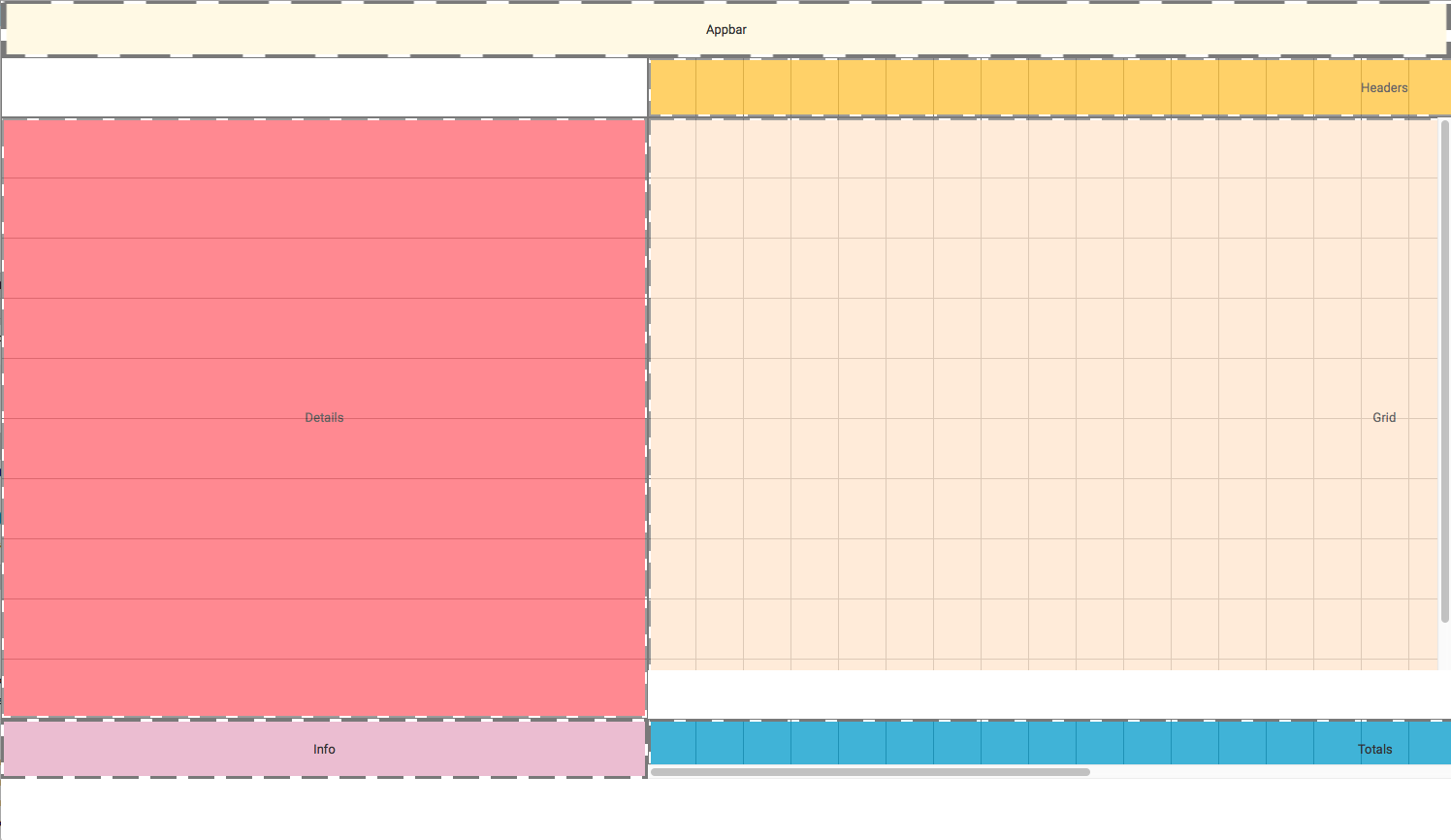

Glitch in the vertical scroll after making the window taller again. The vertical scroll in the grid is still active even thought the window is tall enough to fit the whole component, and there is enough space to stretch it vertically. The window resize action has a script that resizes the grid and the details to make use of the height left by the other components (window height minus the hight of all the other components), so there should be no white spaces. The grid does not properly resize, but details apparently does it, and both are governed by similar scripts, so why does one do it correctly and do other does not? I guess it is linked to the fact that grid has a scroll.

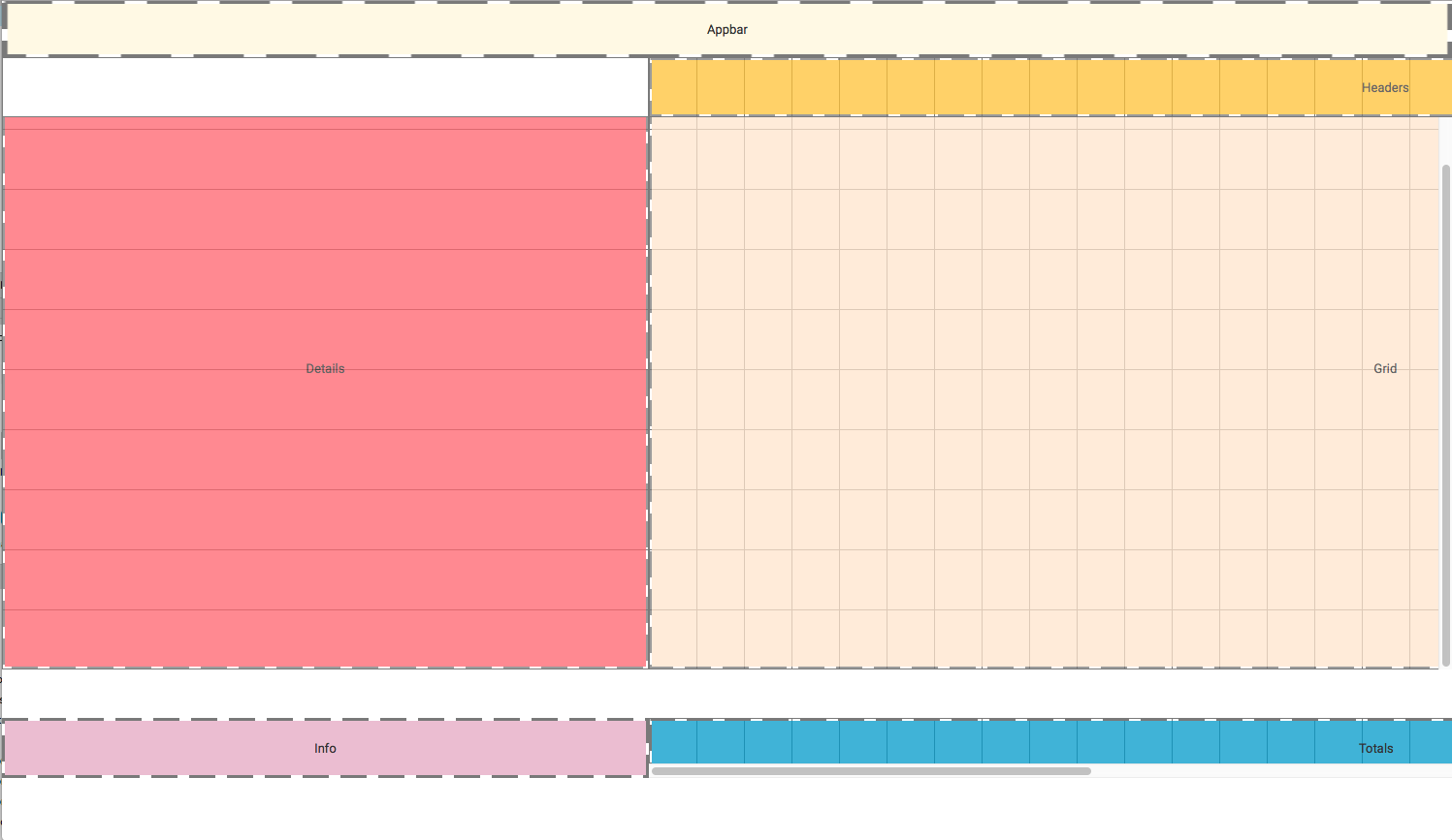

After making the window taller, when scrolling down there is a white space between components that should not exist, the footer should be right under the details and grid. The grid should not have the vertical scroll, so I imagine that it has grown too big for some reason.
