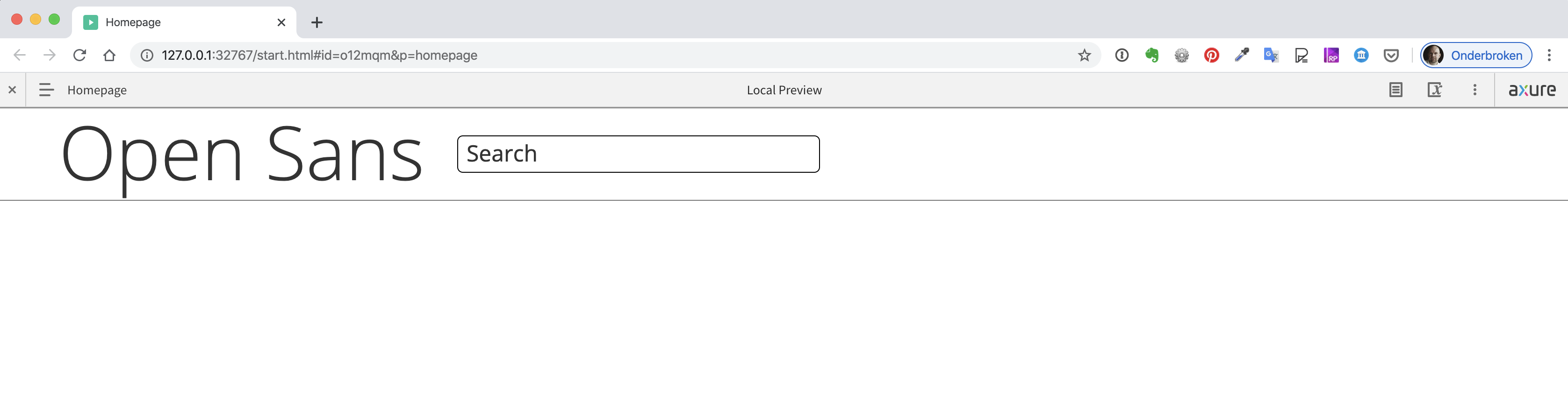

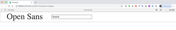

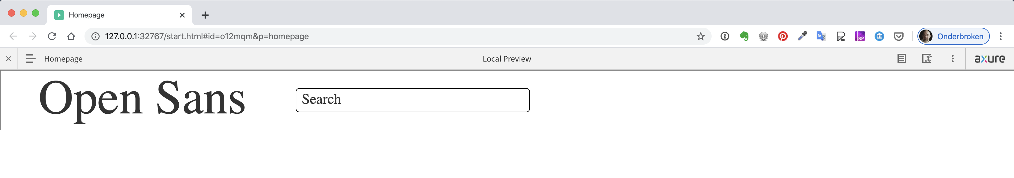

Don’t understand why this is happening. I created a top menu using the font Open Sans. When I preview the design in Chrome all looks well. After that I converted the design for the menu into a master. Then the following problem occurs: When i use the master in a new page it doesn’t render the Open Sans font, but when I choose “Brake Away” and make the design local it does show the Open Sans font . Anybody has a clue as to why this happens? See screen caps off the issue.

Thanks for analyzing it. I noticed that the issue only occurs with the Open Sans font. Which doesn’t make it less strange. I will send the design to Axure!

Does this issue still occur if you try it in a brand new file? Yes
Does it persist between previews? Yes
Are there any errors in the browser console when it occurs? Nope
